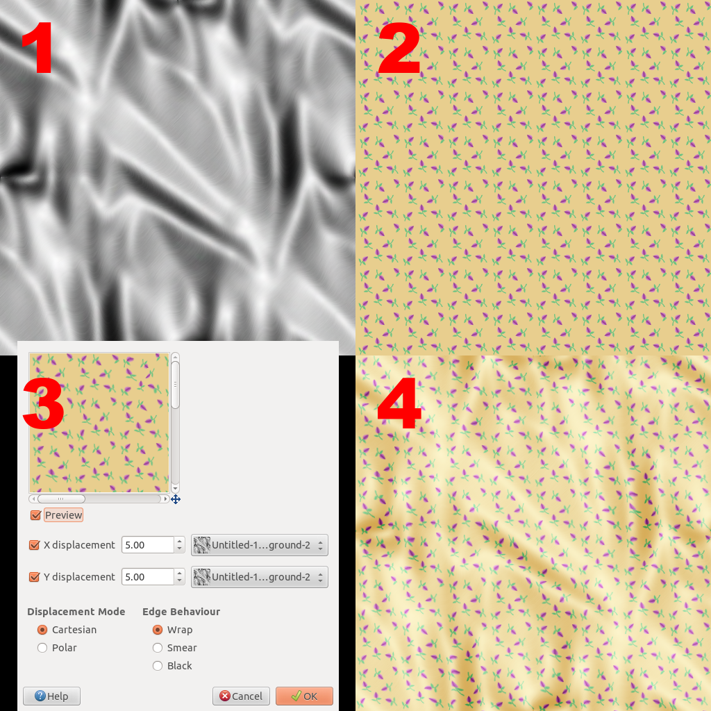

Now you have mentioned you would like to fill a dress with the pattern then I would go for the displacement map filter.
Image 1. I have created a greyscale version of my cloth, showing light and shadow or you could create a depth map of your dress.
Image 2. I have created a new Layer filled with my pattern.
Image 3. Go>filter>Map>Displace and change your Displacement values and set your displacement image as your greyscale dress layer, note the pattern image and the greyscale dress image must be the same layer size.
Image 4. Just to enhance the displacement I duplicated my greyscale image and set it above my pattern layer and changed its mode to "Overlay" this the gives the pattern cloth the lights and shadows of the displacement.
I think you've nailed it He4rty. That's the way he should go. :bigthup

Zeo wrote:
@he4rty & Rod: Thanks for the explanation and example :hehe
Actually that is my method that I use this far (but without displacement map), place pattern layer in front of color (or grayscale) layer and change pattern layer mode. Usually 'multiply' layer mode works better than any other layer mode. If the color don't suit, just 'colorize' pattern layer... :)
... but it feels... err... not natural, so maybe next time I will do it... manually... :(
Using displacement will give the fabric a more natural look.
