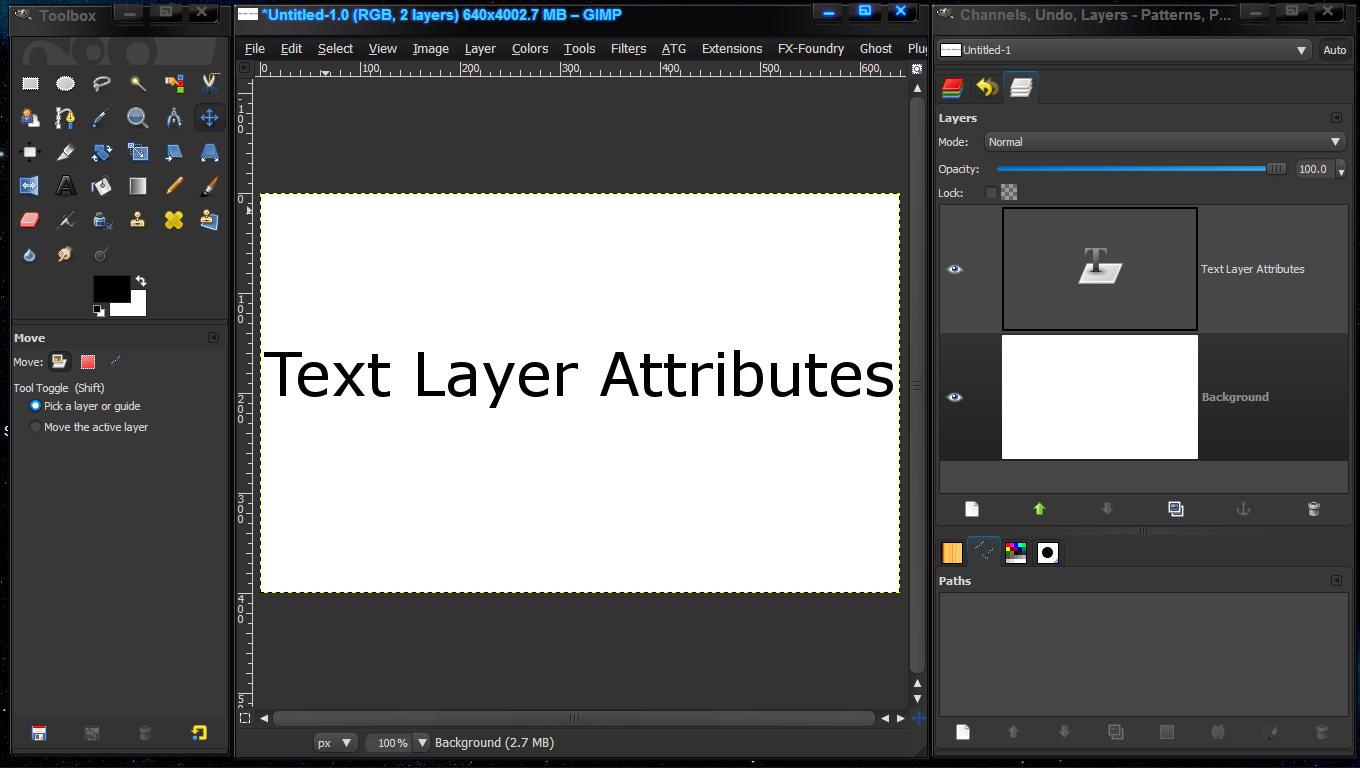

:ninja by K1TesseraEna...
@ofnuts. On my text layer, I have to have a selection to get the text to path in my dialogue.
Shouldn't your text layer look much like the text layer in the image below?
From your screenshot it looks your "text layer attributes" have been remove. So text to path wouldn't apply.

PostPosted: Sat Jan 04, 2014 12:10 pm  (#8)
Thank you kit and Wallace... So once the text layer has been edited, you have to make a selection before you send to path if you want to stroke it with a path.
 Post subject: Re: Text to Path
PostPosted: Sat Jan 04, 2014 12:15 pm  (#9)
Posts: 14284
I believe that you're correct.
Once a text layer has been edited, you have to make a path form some kind of selection to be able to stroke the text along a path.
