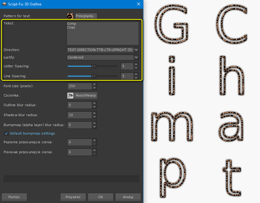

3D Outline
First script from " Gimp-data-extras-2.0.4" - update to new features Gimp-2.10 (especially vertical text).
Rel 2: procedures adapted to Gimp-2.10, added adjust and text direction.
@Level_0
What is Your progress?
@Nidhogg
I don't see the difference either :oops: - but in some cases it does.
