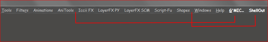

Been tweaking the GUI, and was wondering how to re-arrange the menu entries.
Some of them seem to go alphabetically, but for example G´mic and Shellout went behind Help menu.
I know this is minor, but would like to get to correct places.

Hi Nidhogg just wondering how you set your G'MIC to appear up there.
When I arranged mine it looked like below↓

Nidhogg wrote:
Been tweaking the GUI, ...
How are you going about this "tweaking"?

@ Graechan, I changed it from pluginrc with notepad++
Line 11071: (menu-path "<Image>/Filters/") to (menu-path "<Image>")

PostPosted: Tue Jan 28, 2014 4:08 am  (#5)
put there "<Image>/G'MIC" as menu path

I think Graechan was asking how yours ended up in front of the Help menu item and not before it. Mine also is before the Help menu. Shellout i changed to "<Image>/Export"

I guess the problem is in the fact that Nidhogg changed the menu in simply "<Image>", imo he has to put a menu entry like "<Image>/G'MIC" for G'mic or "<Image>/Export" for Shellout (Rod)

to move where Shellout and G'MIC appear in image menu
adding a / after <Image>/
Yes this works, but then You need 2 clicks because it goes under a G´MIC drop-down menu.
I can launch it straight from menu line now with a double-click, just thought if it´s possible to get into correct place with a simple text edit.
Mikechat´s way did not work.
Maybe I will add another menu "Favs" and put all often used tools there.
Menus getting full because You awesome people make lot of great scripts :bigthup

ya do a 'Favs' menu that'll work
