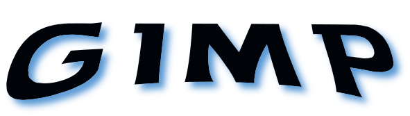

I tried it again and the script worked but this is what I ended up with.

I did all that but the selection won't stroke, it won't fill, I am going to start all over again from scratch, I am not going to let this beat me. grrrrrrrr
I can stroke the text, but it wont fill. I even tried using a paintbrush to fill inside the text but it just paints the stroke.

I can get the the curved or distored path, I can go path to selection but can't go selection to path. I can stroke the selection but it won't let me fill. Every time I try fill, it just fills the outline instead of inside. I know it is something stupid but thats me. It also won't me move the text up into the centre.
As you notice, I can take the paint brush, fill it will a color and I can paint the outline a different, but not the center. go figure.
