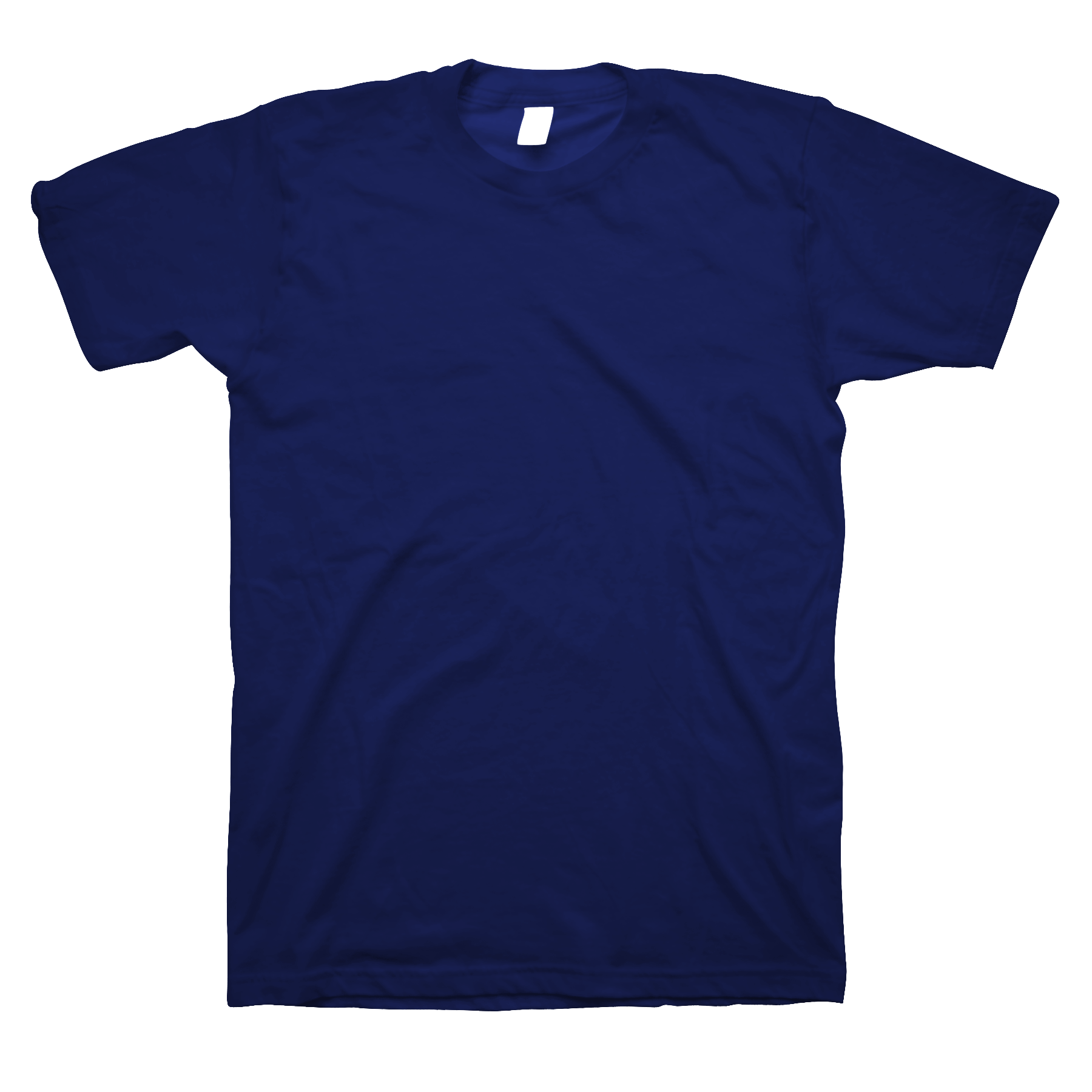

So I've got some colors that I just can't seem to tweak the way that I want them, however with other colors it looks great.
I was wondering if anyone cared to take a stab at it and explain (preferably illustrate in one form or fashion how you did it...)
Also, when I tried to just replicate the colors I liked from one shirt using the drop tool it didn't work for me (maybe I just don't know how to use the tool properly...)
So the following images are the images I like:
Men's: Irish green,purple,royal,black (white like so-so...)
Women's: Irish green
These are the images I am having issues with:
Men's: red,navy,pink teal
Women's: royal,red,navy
In the both the men's and women's colors I am having issues with i'd like to see more of the shadows and light come out in the t-shirts.
You can access all images and xcf. files here:
https://www.mediafire.com/folder/xzv168 ... men's_Tees
https://www.mediafire.com/folder/i6ms42 ... Men's_Tees
As you can see with the blue Men's tee I've uploaded, there's good color, but it's a bit muddy and you can't see details much.
Also the Men's red doesn't quite look basic red to me. Looks a bit dark.
I've been able to tweak contract with certain colors but not with others.
Curious to hear your feedback on how the colors actually look to you currently as well.
Thanks!

Looking at the histograms after decomposing the image to HSL components, th Hue is very constant, so Color/Map/Rotate colors should do the job.
Edit: went digging in your sample; I agree that some with the lighter colors lack a little "pop". I gave a shot to one:
- Color/Components/Decompose (to HSL)
- In the components image: Use Brightness-Contrast on the L layer, increase contrast and augment luminosity a bit to compensate (in the attached image: L=+9, C=+31)
- Color/Components/Recompose

Ofnuts, this looks good. I actually ended up getting a decent looking royal color as well.
The women's template I have managed to get more control over. The men's however I have yet to create a decent red version of the template.
