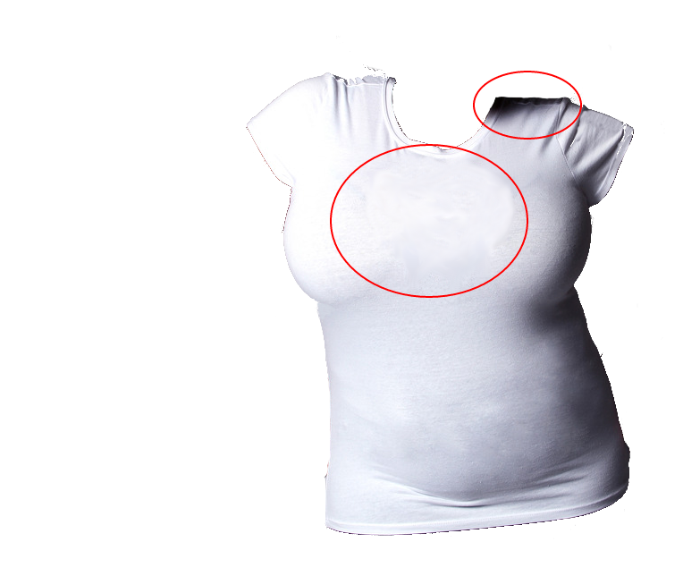

Hey Guys!
So here's what I did fellas,
I basically used a combination of the Add Alpha+Fuzzy Tool + the eraser tool.
What I need now is a way to get much closer (sounds like i need to mask as Wallace did...) to the edges to clean up my image.
I also want to maintain the "photo realistic" look, although I need to get greater consistency of a smooth white tone in the center (LOL I used the clone and smudge tools, it's a bit messy looking...)
Lastly I want to clean up the darker areas i've circled and make them white.

I carefully used the "Clone tool", with a hard-edged brush to remove the t-shirts design. It was very important that I got as close to the design when selecting my clone sample, to try and match with the surrounding areas. I also did the cloning on it's own layer to prevent any mishaps during cloning.
Also when I was finished removing the design. I merged the layers and used the "Smudge tool" at about 50% opacity to even out the areas where the cloning was done (do the smudging with caution). Once I was satisfied I made a selection of the t-shirt and added some "HSV Noise", using it's default values.

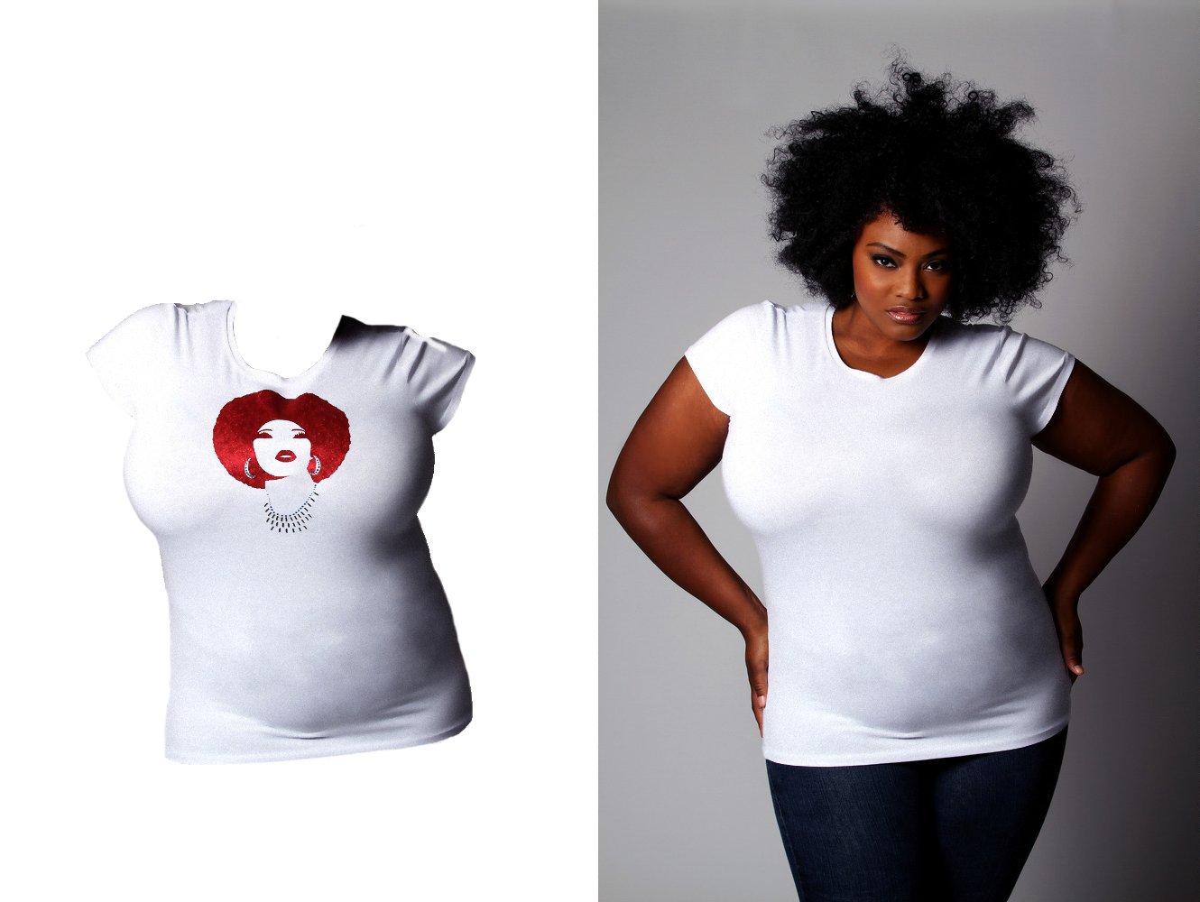

Ok so slowwly making progress here.
If you look at the top right corner of the shirt, you'll see something that looks like cottage cheese or white curd. :hehe
I am having a time trying to lighten the really dark areas (even using the clone tool) I guess it just takes time and 'the touch'.
Wish I could just use the fuzzy tool to remove all of the stuff around the pic I don't see (as evidenced by the image)
Still working... (praying when I try to change colors it will work

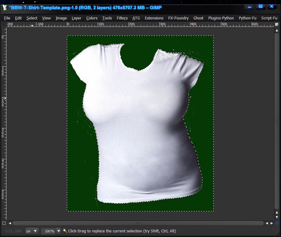

You could "fuzzy select" the alpha space and grow this selection by 1, then use the "free select tool" with the "Add to the current selection" box checked. To select any stray pixels left behind.
Once you have your selection of all the stuff outside of the t-shirt that you want to remove, save the selection to a channel.
Then use this section to remove all the unwanted junk outside your t-shirt. Making sure to shrink the selection by one, when calling it up from "channel to selection".
That's one way to do it, and I'm sure that there's plenty of other way this could be done.
Fuzzy selection of alpha space...
Fuzzy selection Grown by 1...

I actually ended doing that.
