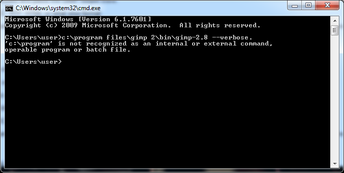

Odin I've never been able to get this command to work, below is all I get

@Graechan
Because the path has space characters in it you need to enclose it in double quotes:
"C:\Program Files\GIMP-2.6.7\bin\gimp-2.6.exe" --verbose
