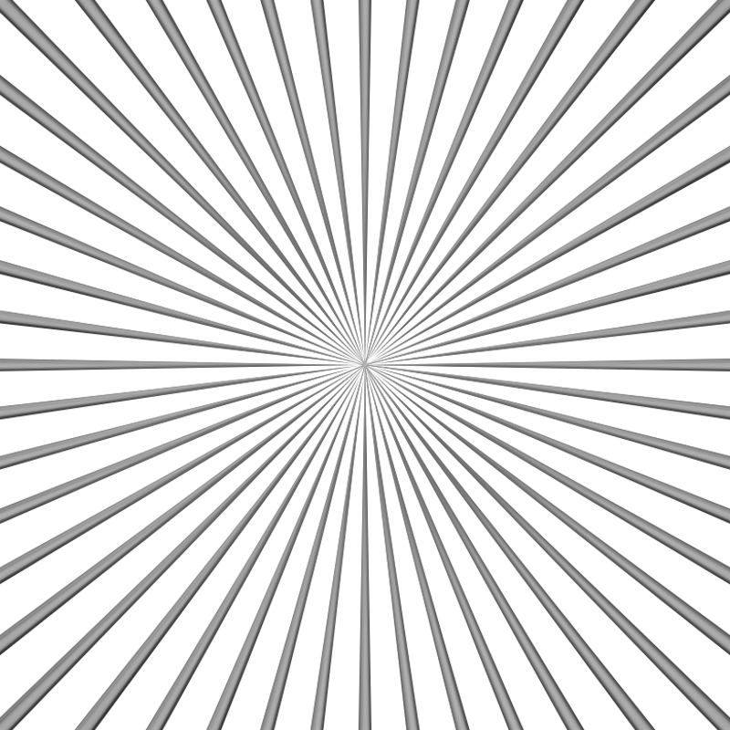

A simple way to do this can be done using a "Line Nova".
By playing with the values in the line nova dialog, you can create this effect.
Make note of the "offset radius" in the dialog. A "0" offset radius will start the line nova in the center of you canvas.
The color of the line nova is determined by what your FG color is. Mine was left as default (Black).
Any other effect would have to be created by you, in whichever way you see fit.

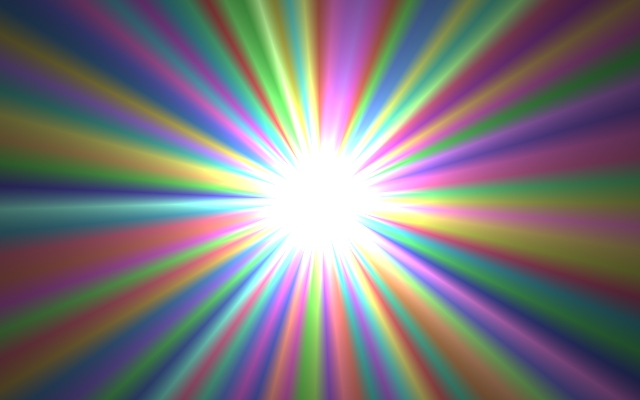

Run Line Nova on a transparent background, duplicate background.
Alpha select each layer, using Shaped (angular) gradients for their specific color combo.
Rotate the duplicate layer (10-12) to show between the original.
Crop excess while positioning the centre offset.
Example, 800x800 canvas.

I ran the line nova and then alpha selected it and shrunk the selection a little. Then added a lighter color to the selection on another layer. Then I Gaussian Blurred this layer. Then did another alpha to selection on the original layer. Inverted the selection, and used this inverted alpha selection to remove the excess from the layer above it with the lighter color. After merging the layers, I scaled it to slightly larger, and did a "layer to Image size".
That's what I did in this image below. Then lowered this layers opacity until it look good to me.

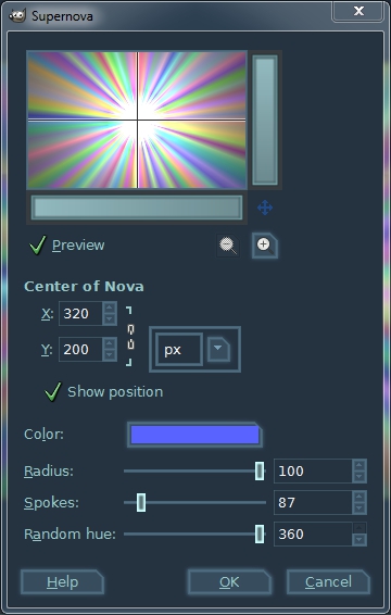

Supanova can create this type of background
