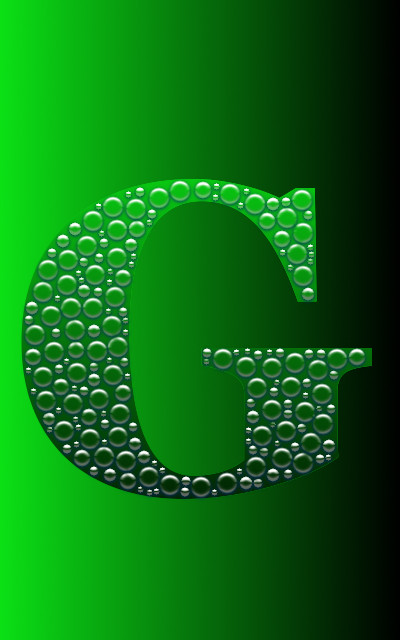

I liked this old script ..
Works almost fine in Gimp 2.8 ... hangs a bit
Would like it to work in 2.10.20 (Windows) too.

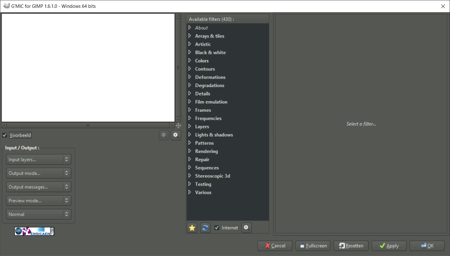

What version of G'mic is running on your 2.8?
Pack sprites works fine in current G'mic v 2.91, but the settings are a bit different than those on the script.

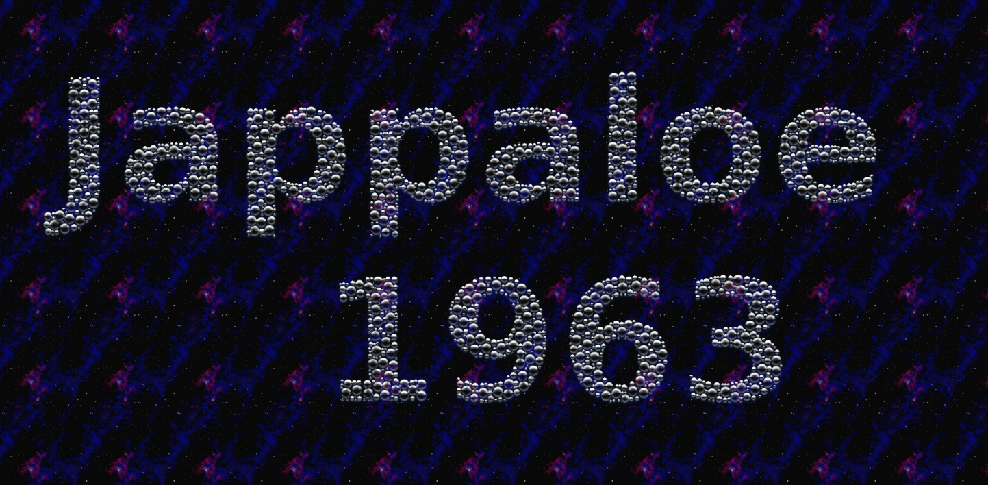

Changes made:
- adapted to GMIC > 2.9,
- adjusting the new scope: plug-in-bump-map,
- layer mode names changed,
- changed deprecated procedure:
1. gimp-selection-load -> gimp-image-select-item,
2. gimp-image-get-layer-position -> gimp-image-get-item-position,
3. gimp-drawable-set-name -> gimp-item-set-name.
In menu Gimp:
- File/Create/Logos/Air Bubbles...
- Filters/Alpha to Logo/Air Bubbles...

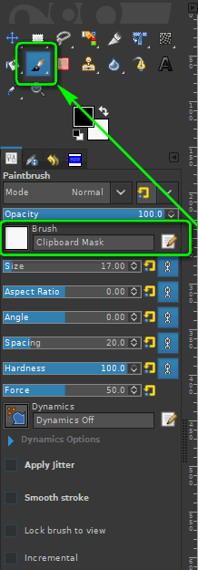

Script creates a brush from the mask's clipboard - it is recommended to choose Paintbrush before running the script.
I didn't have time for thorough tests - when you find any error, post a screenshot of the message.

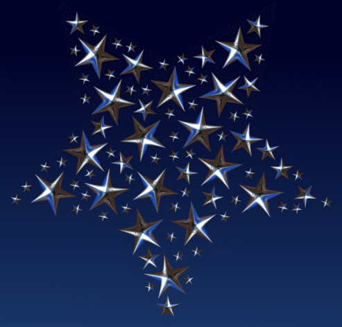

I haven't downloaded MareroQ's revised script yet, but you can use G'mic "Pack Sprites" with any shape you want easily enough.

Thank you ... it works.. i'm happy

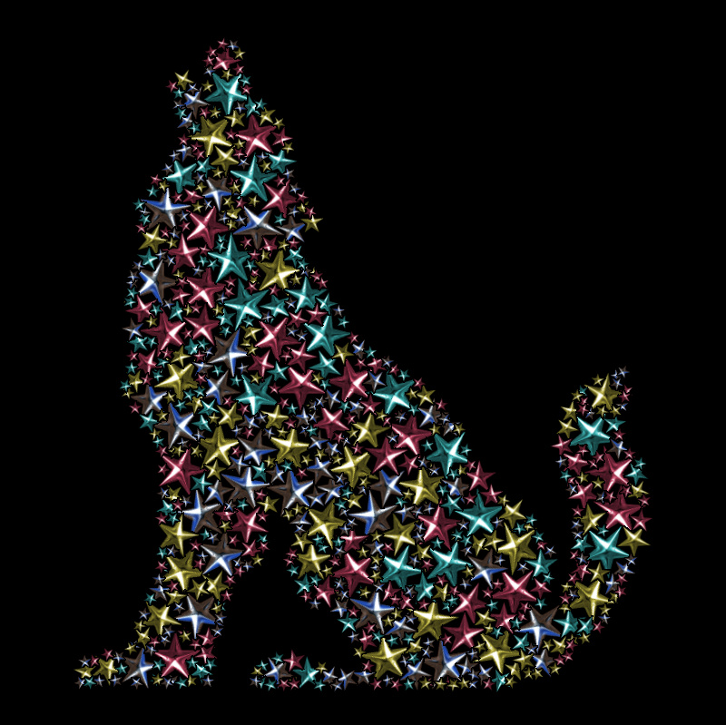

Just learned how to do this today and I like my manual method much better than a very limited script.
I tried to fix the script, but the gmic call is not working. It doesn't produce any errors, just creates ONE bubble. So, like you, I manually used Pack Sprites in GMIC and found that if you (example: your stars) create more than one layer of a star (I used the Wilber brush in 5 different colors on 5 layers) it produces a much better result.

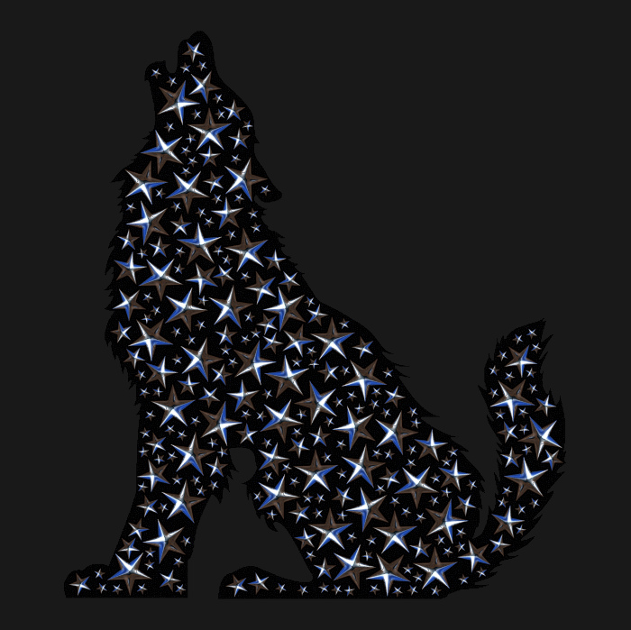

I tried it with with 4 layers of colored stars and it definitely gives it more texture and looks cool.

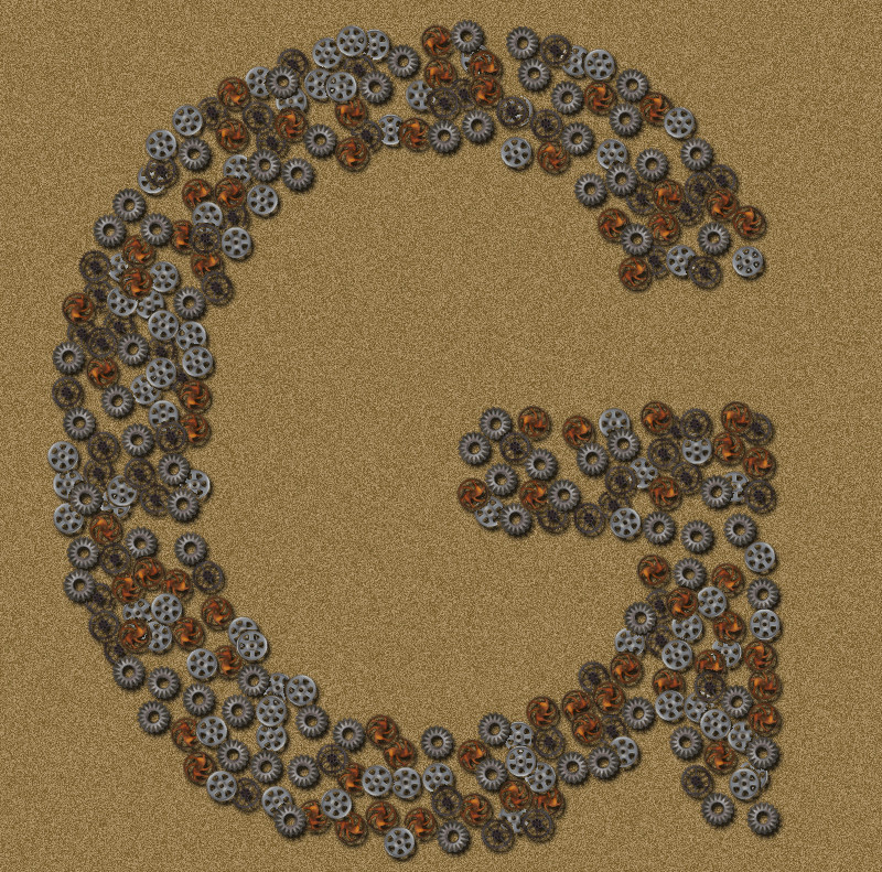

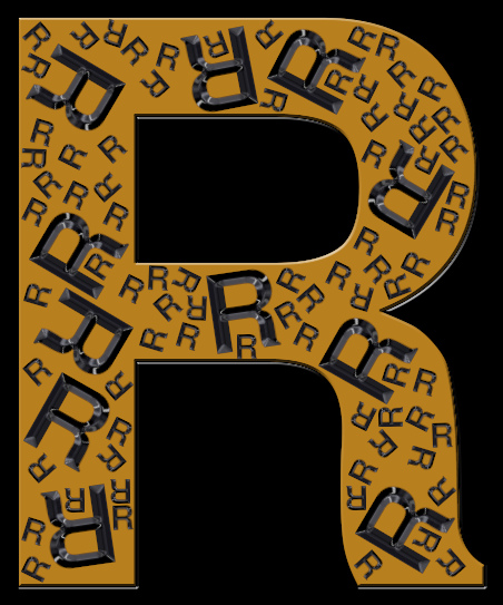

PostPosted: Tue Jul 07, 2020 7:03 pm  (#19)

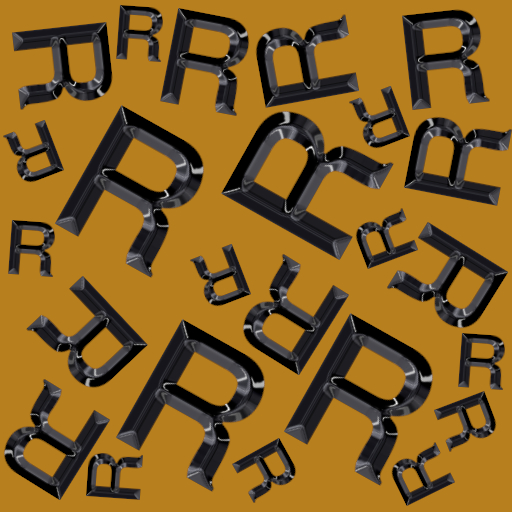

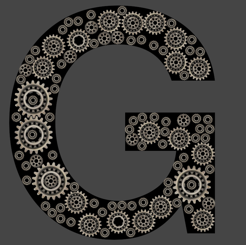

I used my own settings, it can be a bit unpredictable. Lot's of trial and error. Here I was playing with gears.
