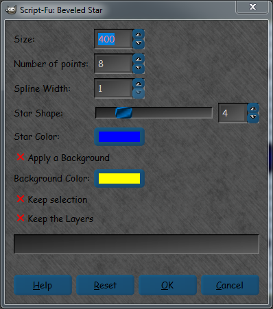

PostPosted: Tue Aug 13, 2013 9:34 pm  (#1)
This script follows an excellent tutorial from PegLeg44 Here with settings for colors and the number of 'star-points'
Examples and Menu below↓
Menu Location Script-Fu/Shapes
