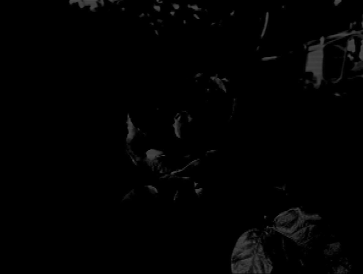

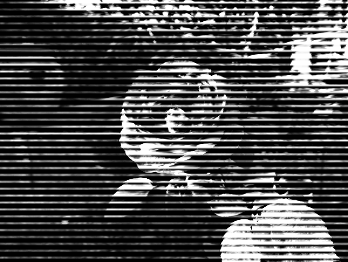

 Post subject: Re: A problem using a variable with vector-set! to set the foreground
PostPosted: Sat Dec 27, 2014 11:49 pm  (#13)
Hi Saul,
you write "I am wondering what you are seeing to indicate that the line width is interpreted as "40""
It was only a guess (wrong) after having seen the different results from my test script.
Here they are:
image obtained by using "quotient" (the values are in all cases 9 as dividend and 2 as divisor)
image obtained by using "trunc"
image obtained by using "round"
you may easily understand the reason of my guess (wrong)
but what is definitely true for me is:
while quotient and trunc return a pure integer without any appended fractional value, i.e. simply 4, round returns a value which is not a simple 4, maybe a float value, IDK
you are right when saying that the filter should take care of what it expects, but from a coder point of view who makes use of an existing filter I'm right in preferring to use trunc and not round, for safety... at least as long as the behaviours will not be equalized
