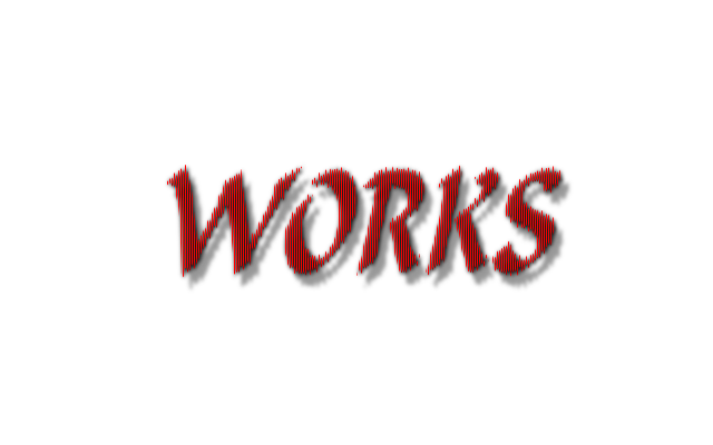

I had time to run it real quick before i left. Worked fine for me guys. :)
Instructions -
1) Create a new document
2) Create your colored text layer
3) Select the text layer and run the script.
My settings for the below image results were 7, 7, 11, both vertical directions.
XCF workspace file attached.
text-embroider-test-2014_RD.xcf [198.07 KiB]
Downloaded 138 times

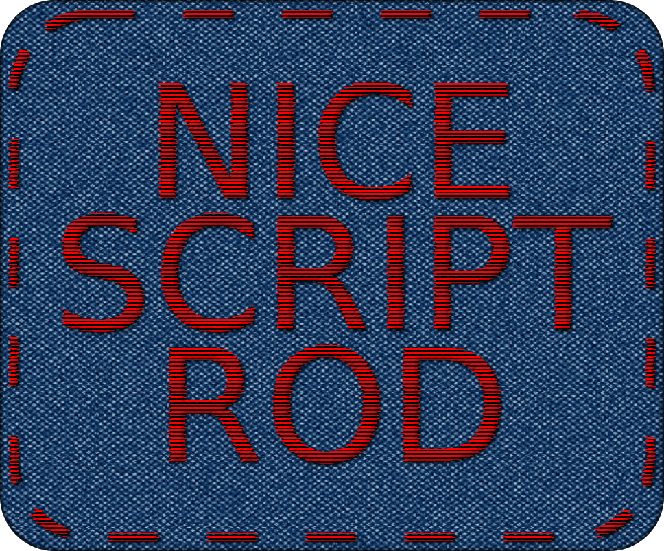

 Post subject: Re: Text Embroider V-1.0 - Updated to 2.0
PostPosted: Fri Jan 10, 2014 1:11 am  (#27)
Posts: 12865
Stroked outline with my yarn brush, then ran the Script-fu. Blended the bevel result this time. :)
