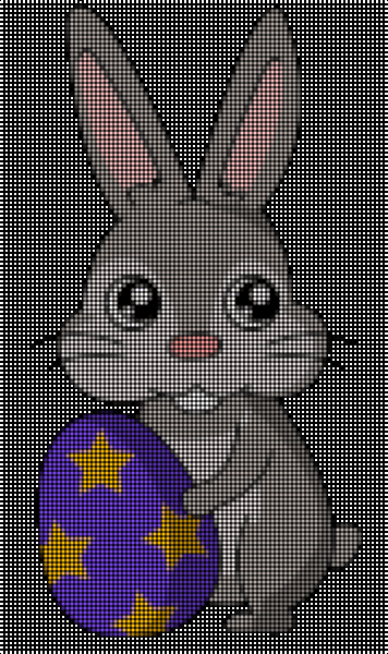

Turn an existing animation (ie: https://giphy.com/gifs/animated-the-bea ... DP1YMziaQw) into a LED-animation like below
Instructions:
1. Scale down an animation (animated gif) so that it's not too big (since each pixel will be treated as a LED bulb).
2. Scale up by 20 times (INTERPOLATION NONE)
3. Run plug-in below from /Python-Fu/LED Animation from Animation...
4. That's it, scale down to taste. and save as animated gif.
5. Enjoy

Hi Tim.
Small conflict: in two different plugins (LED Animation.py and LED Animation from Animation.py) You used an identical name for 'registry': "python_fu_LED_animation" (so only one plugin shows up in the menu) ;)

PostPosted: Sat Apr 01, 2023 6:23 am  (#4)
Posts: 4554
cut and paste error :D
 Post subject: Re: LED Animation from Animation Plug-in
PostPosted: Mon Apr 03, 2023 1:21 am  (#5)
Posts: 12845
Pretty cool DMD effect as well, Tran. :)
