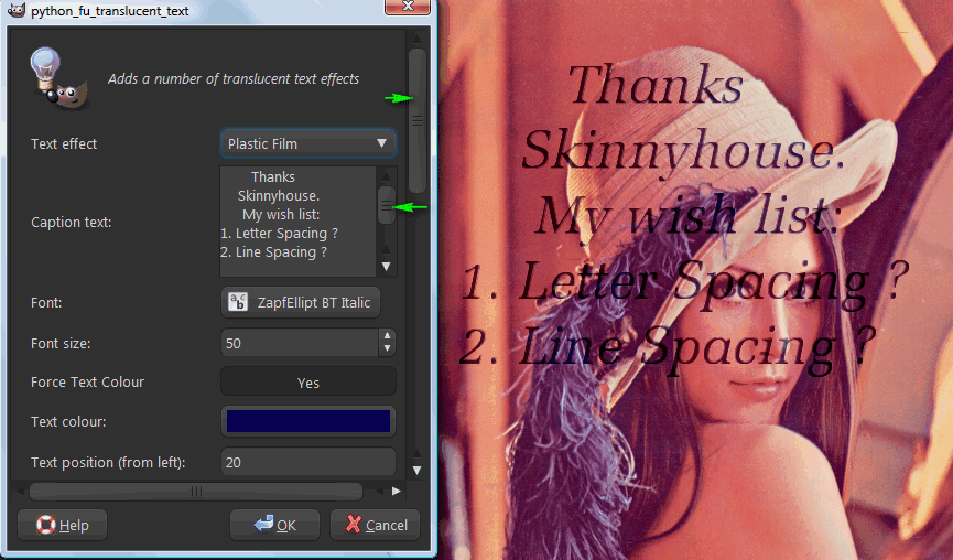

Skinnyhouse: I am unable to see the last few choices at the bottom of the long dialog box. It will not let me shrink it down so that the scroll program would work. Is anyone else having this problem?
 Post subject: Re: New Version: Version 1.01 Translucent Text Styles Script
PostPosted: Wed Sep 07, 2016 10:36 pm  (#6)
Posts: 14269
You need to install the Script-Fu Scrolling Interface.
You can pick it up here.
Edit:
I'm sorry but this won't work with python plug-ins.
You could use AltDrag.

Python Scrolling Interface:
http://gimpchat.com/viewtopic.php?f=9&t=13714
It works very well.

Posts: 16261
Actually i use the gimpfu.py by Bytes and Pixels. It arranges everything into vertical columns. :)
This has to go in your \GIMP 2\32\lib\gimp\2.0\python folder and replaces the original. REMOVE the original and KEEP IT SOMEWHERE SAFE! In case you need it again. :bigthup
RESTART GIMP after installing this file so it can be re compiled.
Remember when you update GIMP in the future you will need to re-install this python file. That is if you still want to.

PostPosted: Thu Sep 08, 2016 11:35 am  (#11)
Thank you Rod. The gimpfu plug in works nicely.
