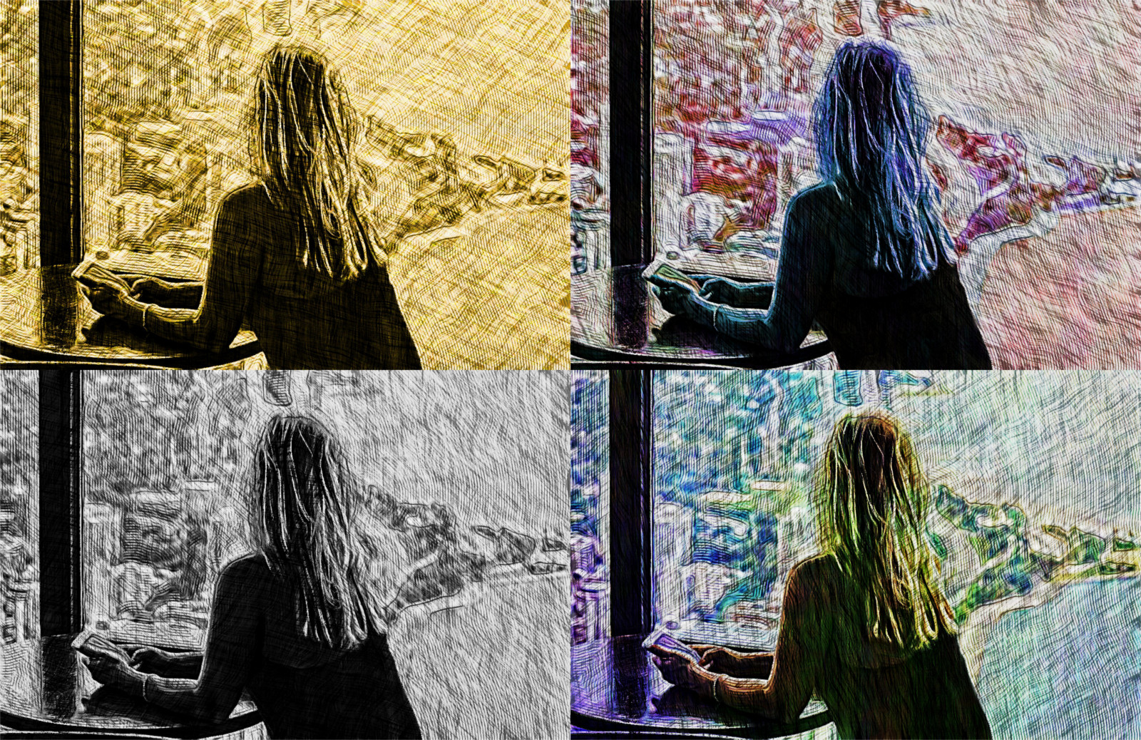

PostPosted: Sun Nov 13, 2016 8:07 am  (#7)
A "quartet"

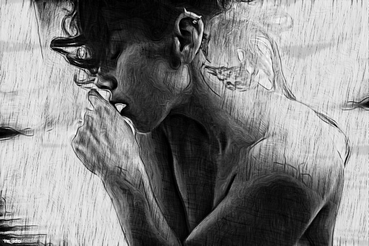

Another toy to play with! Thank you so much Dinasset. You are so productive to making Gimp Chat members enjoy so much. :tyspin :jumpclap :jumpclap
studio-660804_1280-moderate brighten-intensity3-set.jpg [ 879.15 KiB | Viewed 6452 times ]
portrait-1332624_1280-moderate brighten-intensity4-set.jpg [ 1.5 MiB | Viewed 6452 times ]
blonde-1567265_1280-moderate darken-intensity4-set.jpg [ 919.25 KiB | Viewed 6452 times ]

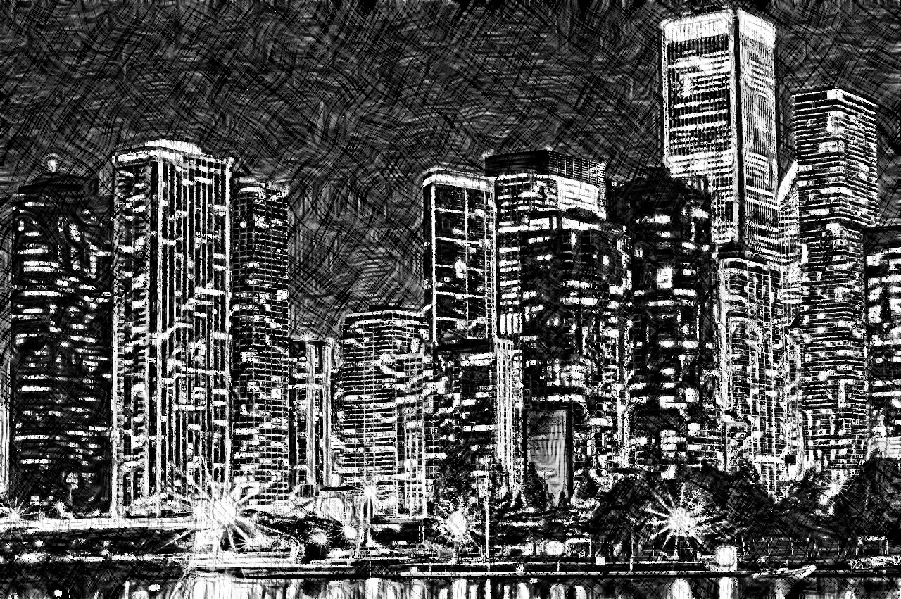

building-1809631_1280-CrazyHedcutDrawing-moderate darken-intensity4-overlaysource-source-duplicate&merge.jpg
building-1809631_1280-CrazyHedcutDrawing-moderate darken-intensity4-overlaysource-source-duplicate&merge.jpg [ 936.42 KiB | Viewed 6451 times ]
building-1809631_1280-CrazyHedcutDrawing-moderate darken-intensity4-overlaysource-invertedcolours-duplicate&merge.jpg
building-1809631_1280-CrazyHedcutDrawing-moderate darken-intensity4-overlaysource-invertedcolours-duplicate&merge.jpg [ 929.34 KiB | Viewed 6451 times ]
building-1809631_1280-CrazyHedcutDrawing-moderate darken-intensity4-overlaysource-grayscale-duplicate&merge.jpg
building-1809631_1280-CrazyHedcutDrawing-moderate darken-intensity4-overlaysource-grayscale-duplicate&merge.jpg [ 597.22 KiB | Viewed 6451 times ]

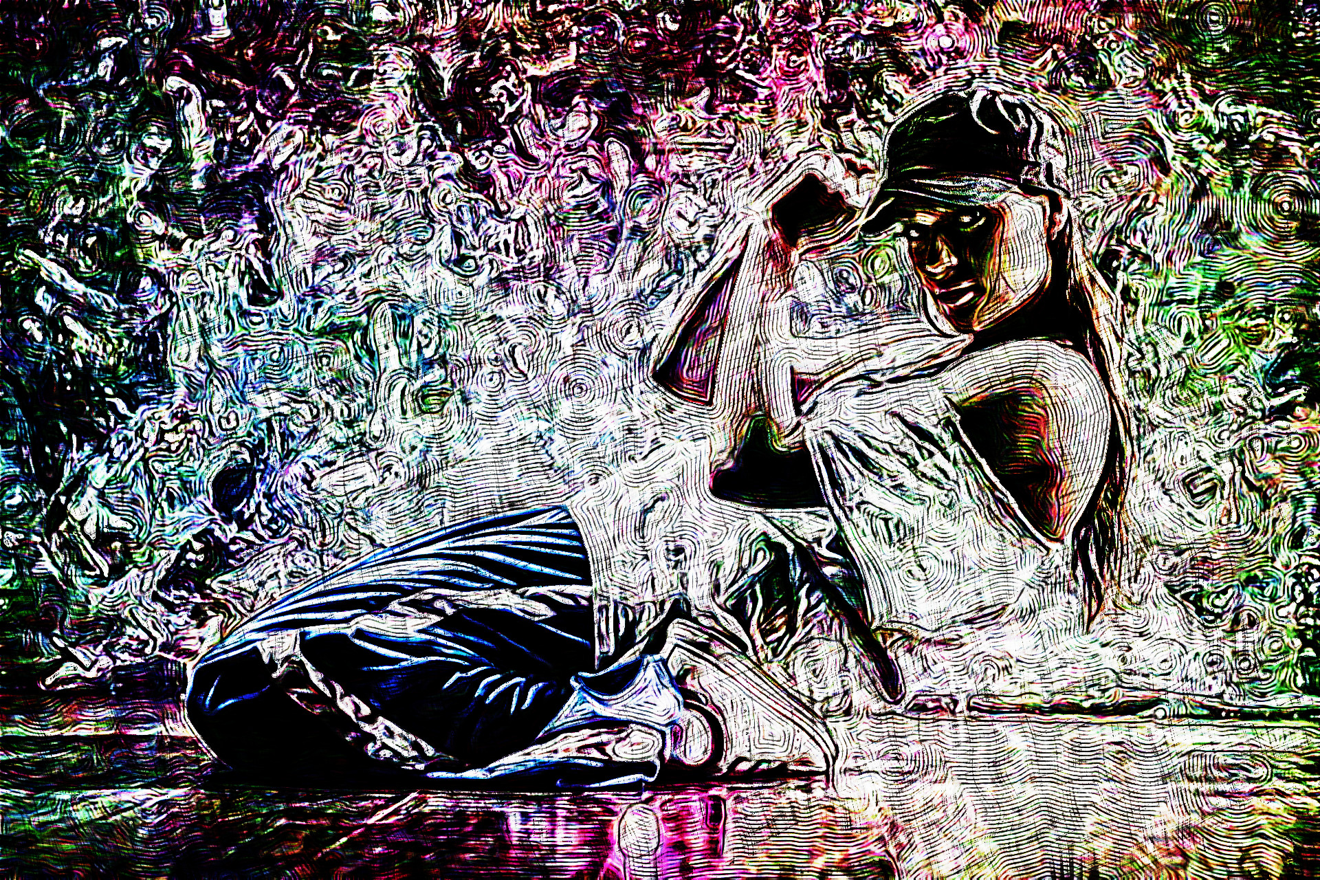

I love the results, I think I'm going to be addicted to this filter, too.
Lovely results in this filter, Rod. Your dog is really a star here in Gimp Chat. :)
girl_dancer_054553-CrazyHedcutDrawing-intensity7-grayscale.jpg [ 1.22 MiB | Viewed 2439 times ]
girl_dancer_054553-CrazyHedcutDrawing-intensity4-source.jpg [ 2.04 MiB | Viewed 2439 times ]

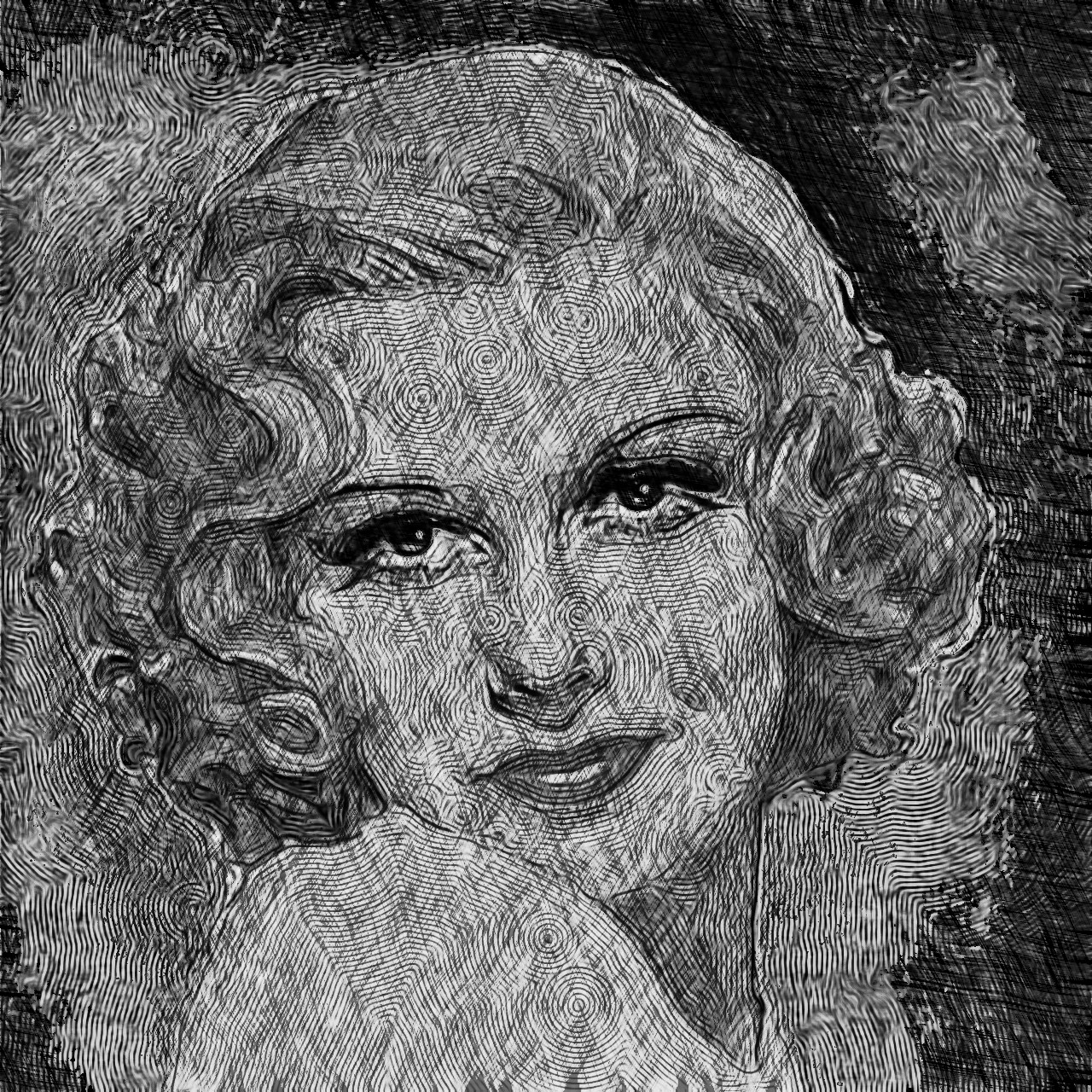

I just had to add one here before the art thread is started
