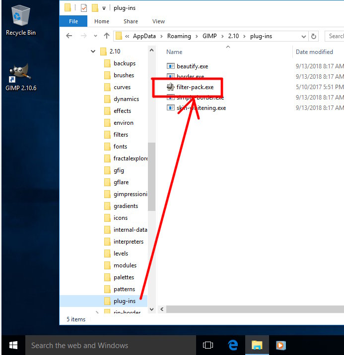

Unzip it and add to your Gimp 2.10 profile. C:\Users\your-name\AppData\Roaming\GIMP\2.10\plug-ins
Where to find in the menu structure? Bottom of the Colours menu.
