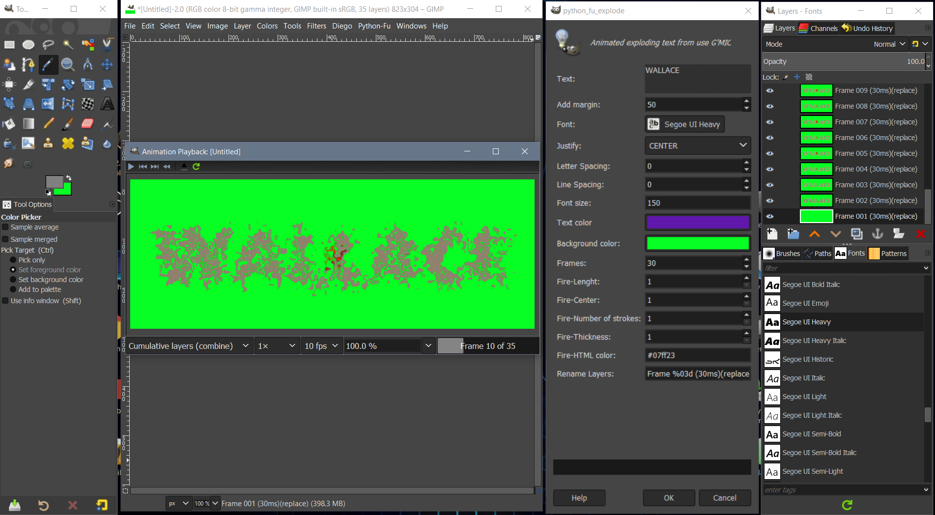

mackenzieh wrote:
How did you get the purple and green colors?
By using purple for the text color and green for the backgrpund.
I also put the HTML code for the fire.
To the same green background color #07ff23.
 Post subject: Re: Can Any Script Coder Produce 'Exploding Text'?
PostPosted: Thu Feb 06, 2020 11:13 pm  (#9)
Joined: Jul 06, 2013
Posts: 2667
Location: California
Wallace wrote:
I also put the HTML code in for the same green background color.
Oh, okay. Now, back to my original questions, how can it be slowed down and can the html fire color be changed?
PostPosted: Thu Feb 06, 2020 11:29 pm  (#10)
Posts: 14281
mackenzieh wrote:
At the bottom there is a Rename Layers setting.
That seems to have the delay time.
I guess you just change the milliseconds to whatever you like.
I did change the HTML color to green,
by simply typing in the html code for the green I was using,
but somehow there is red in the image.
:hehe

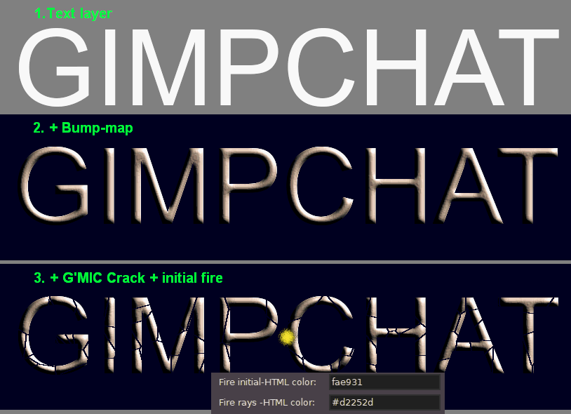

Some remarks on the concept of development:
1. For startup text I used plug-in-bump-map.
I'm sorry I forgot to add that it doesn't work without the "patch" using the Gimp 2.8 version.
Then I applied the Gmic filter Patterns -> Cracks.
For the beginning, I only assumed the red color - but now you can also choose it.
Why HTML?
The color output Gimp rgb(r, g, b) -> r, g, b = 0÷1 does not match the color input in G'MIC rgba (r, g, b, a) -> r, g, b, a = 0÷255 - but both can use HTML (maybe there is another solution?)
2. For fire-lines I used GMIC -> Testing -> Samj -> Rendering -> Traits Strokes
There are many other possibilities:
- elsamuko-escape-lines.scm
version (0.3) fixed for Gimp 2.10 with new Autocenter option:
viewtopic.php?f=9&t=17996#p247091
- Speedline Plug-in (speedline.exe)
viewtopic.php?f=7&t=7769
3. For explodind (defoormations) I used GMIC -> Deformations -> Crease
This should be replaced by some other deformation (any ideas?)
