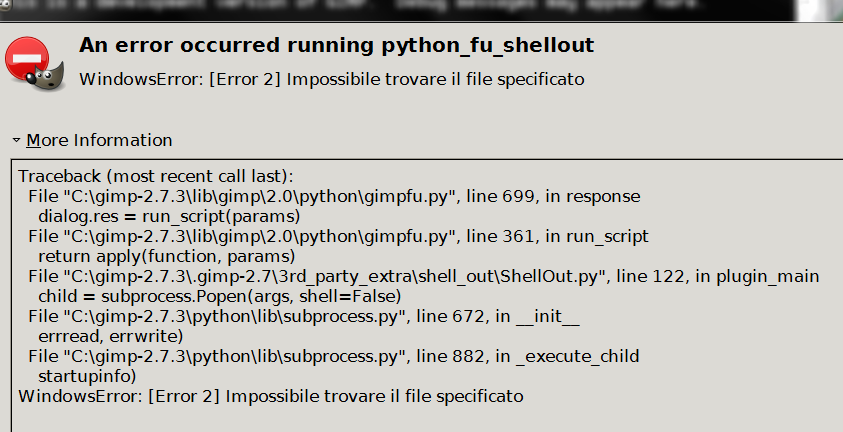

i tried both , no joy :gaah
not sure if the error message may be useful

I can't check everything as your link to the zip is in a banned place from behind the corporate firewall :gaah
But you have a mistake in the code you've posted. You have a square-bracket pair missing from the register block. It should be:

Don't worry about putting your zip file somewhere else, I could get to it when I am at home.
But I think I know why it's not working with relative paths. The problem with relative paths is that they are relative to the current working directory. On Linux that may be the plug-ins directory, but on Windows it's not so simple.
If I start GIMP by double-clicking the executable C:/Program Files/Gimp-2.0/bin/gimp-2.0.exe, then the working directory is C:/Program Files/Gimp-2.0/bin/ and the paths are relative to there.
If I start GIMP from a short-cut, where the Start in field is set to "%USERPROFILE%\My Documents\My Pictures", then that is my working directory and paths are relative to that directory.
You will need to find out where the current working directory is and specify the relative path from there.
To find out the current working directory I added a line to your code before " # Invoke external command":
  raise NameError(os.getcwd())
Which generates an error:
NameError: C:\Program Files\GIMP-2.0\bin

But I think to know why it's not working with relative paths. The problem with relative paths is that they are relative to the current working directory.
You hit the nail in the head !!
That was my first doubt try to use relative path:
relative to WHAT ?
But then i hoped that the most simple and logic , relative 1 of the 2 extremes , in this case relative to ShellOut.py and leading to the app to call so " ./XnView/xnview.exe"
(or "/XnView/xnview.exe" or ".//XnView//xnview.exe but anyway the starting point of the path was the active script that had to use the path )
I had some doubts (as...maybe was Python.exe to execute the script so the path should start from python.exe ?) but i was hoping for the best...i mean what the sense of a relative path if is so hard to guess know , to WHAT is relative ?
I really hope to clear this point and to solve, i am stuck here from a couple a weeks

In GNU/Linux, any path which does not start with slash ("/") is relative. If it starts with a slash then it is absolute, more commonly referred to as "fully qualified". Note that I am referring to the expanded pathname, if your pathname starts with a variable (e.g., $HOME/.gimp-2.6) then it is the pathname that results after the value of $HOME is substituted that determines whether the path is relative or fully qualified.
For GIMP, all relative paths are relative to the working directory at the time GIMP is started. If you are starting GIMP from a desktop icon then this working directory is usually specified as a property of the icon (in Windows, I believe there is a shortcut preference called "Start program in..." or somesuch).
It is possible that the ShellOut plug-in is changing the working directory before searching for the files (but I doubt it).

This is getting very confused, let's see if a picture can help:
Are my assumptions correct? If so then the relative paths are from the GimpPortable.exe:
"App\\gimp\\lib\\gimp\\2.0\\plug-ins\\FontFrenzy\\FontFrenzy.exe"
and
"App\\gimp\\lib\\gimp\\2.0\\plug-ins\\XnView\\XnView.exe"
I will say that I can't try this as I don't have Python installed with GimpPortable (is this possible?)
I also got the zip file downloaded and FM_shellout.py has a number of mistakes:
The missing [], line from the register block.
The command
  command = "\".\FontFrenz\FontFrenzy.exe\""
should have had double backslashes (see above) and the directory name is spelt wrong: FontFrenz
I think you should have:
  command = "\"App\\gimp\\lib\\gimp\\2.0\\plug-ins\\FontFrenzy\\FontFrenzy.exe\""
