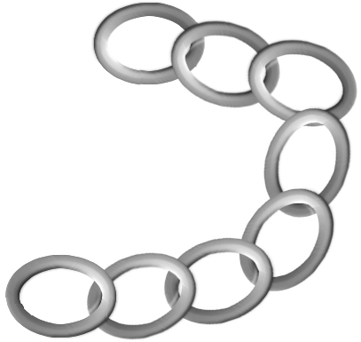

I gave your plug-in a try. I also have RobA's so now I have two rotator brush-makers. :mrgreen:
It works great, dd.
It's a chain link. Wish I knew how t make them actually linked inside of each other.

It works great, dd.
The secret to this is making the linking portion of the chain the core of the image. I guess it would be worth a shot to see if it would actually work. Not sure if it will.
I understand what you mean but they don't line up on a curve. A single brush on a straight line works fine.

bkh1914 wrote:
Have you seen this chain brush:
Gimp Chain Brush by Chrisdesign
It isn't a flat chain, but...
Ah! Thanks bkh! I think the secret that makes it work is the flat turned link. Need to work with that in mind.

mahvin wrote:
Now I am curious as to how a stroked path would treat the chain (probably the same as the animation).
I made an ellipse and saved it to path. That chain is the result of that stroked path.
