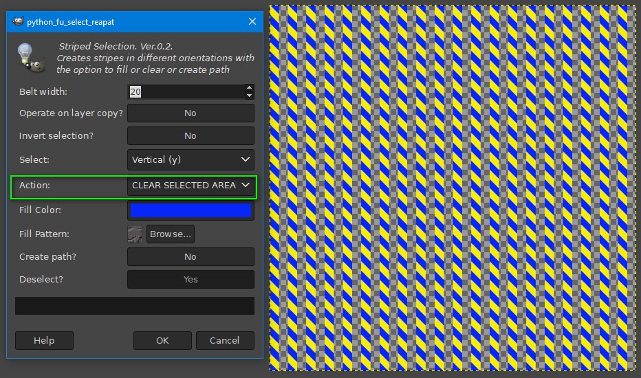

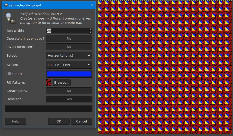

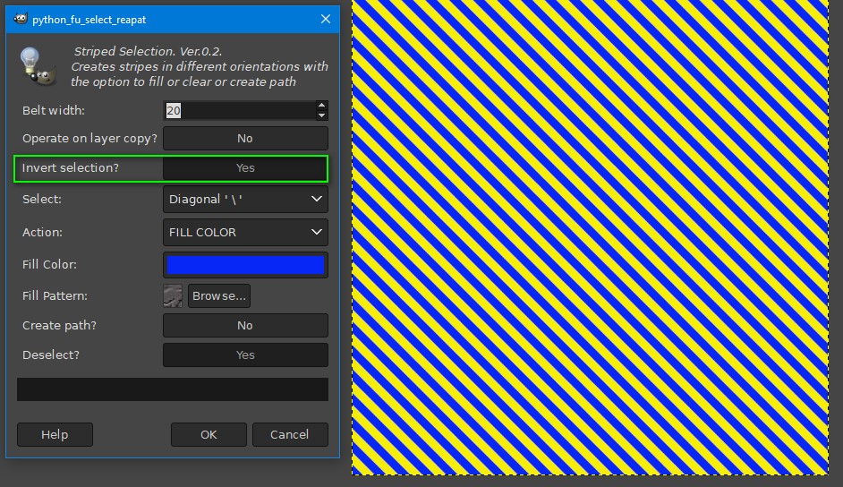

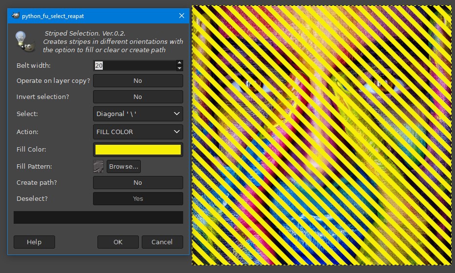

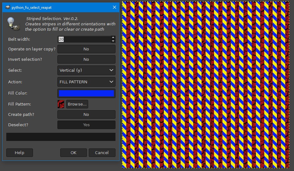

The plugin is very fast - it takes less time to start than to execute (I even thought for a moment that it didn't work).
I took the liberty of extending Your plugin.
A few small examples:
Striped Selection.zip [2.02 KiB]
Downloaded 204 times
