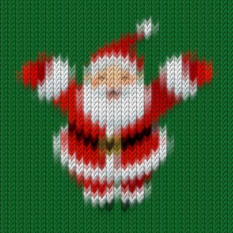

Nice work, thank you Tim :clap :tyspin
I gave it a try using the first version of the plug-in but to make the pattern match I had to scale it by 1/4 so from 104x65 to 26x16. Didn't try the version in post #5 as I was too confused by the scaling by then.
Is it too early for a Christmas jumper?

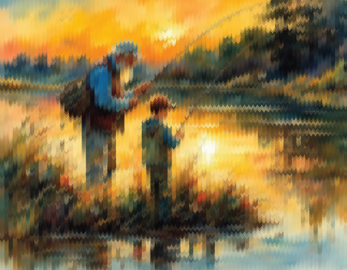

Thanks again Tran. I tested your Knit Colors v2 of the plug-in.
I think that the result is better about quality of the final image.
However I must say that the plug-in had much time, more than before.
Here my result.

Issabella: for some reason your image looks like it's an image that is has not been ran by plugin since the image is still there and not shaped like the knitted coloring.

Thanks Tin. Please, is it alright now?
I applied a third to reduce the pattern.

it's better but it still doesn't match exactly as you can see some V's with more than one color.

It's like this for example if you chose to scale the pattern.png that I attached by 50% then choose plug-in to run a 1 half.
If you scale pattern.png by 25% then choose plug-in to run at 1 quarter. and it'll match perfectly :D

I decided to make it less confusing and have the plug-in do all the dirty work.
This version of plug-in has the pattern.png encoded/included inside it so you don't have to deal with pattern.png at all.
Just specify what width (in pixels) you want the individual knit-V shape to be.
It'll create multiply layer and pin light layer, you'll just have to play opacity of these two layers and possibly blur the colored layer (2px blur radius).
Issabella I think you'll like this version of plug-in
File comment: release 3. includes pattern.png inside the plug-in so you don't have to deal with manual making multiply mode and pin light mode just adjust opacity of those two layers afterwards to taste if you like
knit-colors.zip [16.48 KiB]
Downloaded 1862 times
