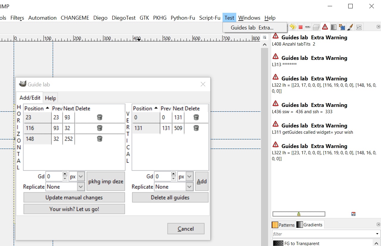

Am on the way
There is a new button: Your whish! ..
And your real wish is not yet 100% explained!
That 'must' be mathematically precise! Example you could wish to select TRIANGLES ? :hehe
Look into Error Console after L322 there is the info hidden about what
guides I had in the picture ...
 Post subject: Re: Python or Scheme script request
PostPosted: Mon Sep 19, 2016 6:32 am  (#20)
Posts: 16256
PKHG wrote:
Am on the way
You lost me here, sorry. :(
So what does the "Your Wish. Let Us Go" button do?

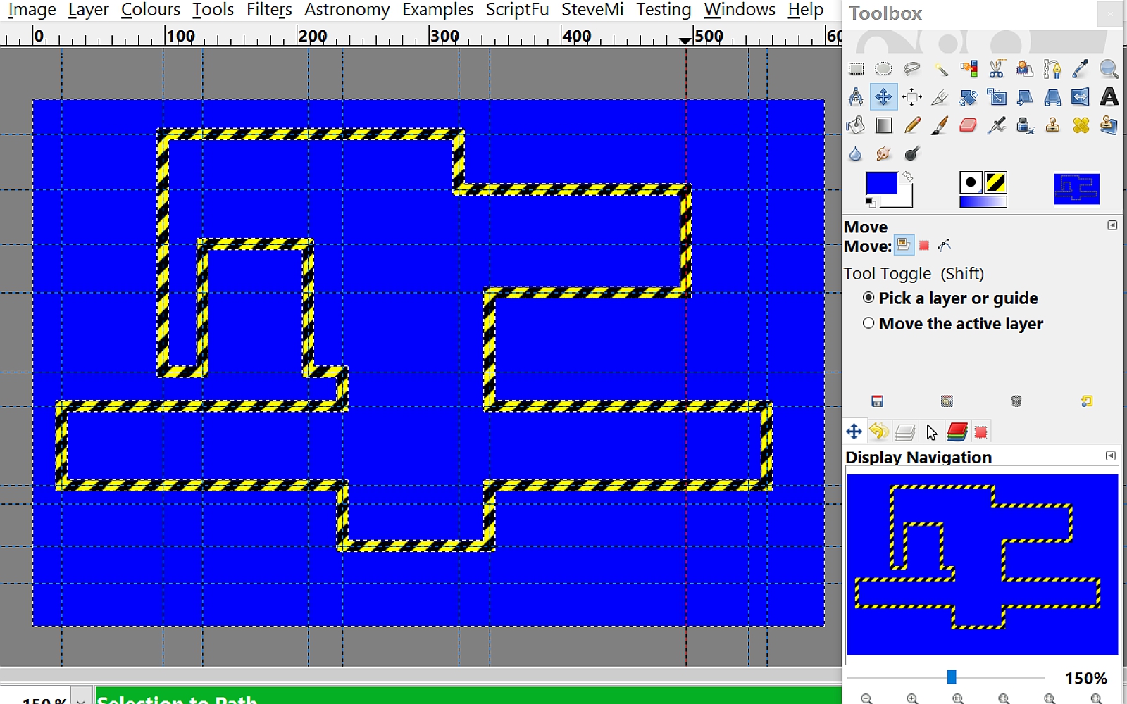

An interesting idea, which I couldn’t get out of my mind wondering if it could be done. I got the selection from guides working then gave up on it, as I agree with ofnuts that it’s a roundabout way of doing things. I’ve uploaded the script here for anyone curious
oo-guides-to-selection-mk2.scm [2.53 KiB]
Downloaded 340 times
Located at <Image>/Script-Fu/Guides to selection
It is an unfinished script with no error checking and will crash or can give odd results if the user doesn’t
Add 4 guides, must be 2 vertical and 2 horizontal (the order of placement doesn’t matter)
Run the script
Repeat x number of times
Path to selection
Stroke path
PS You may need to Re-start gimp and have only one image open before using
