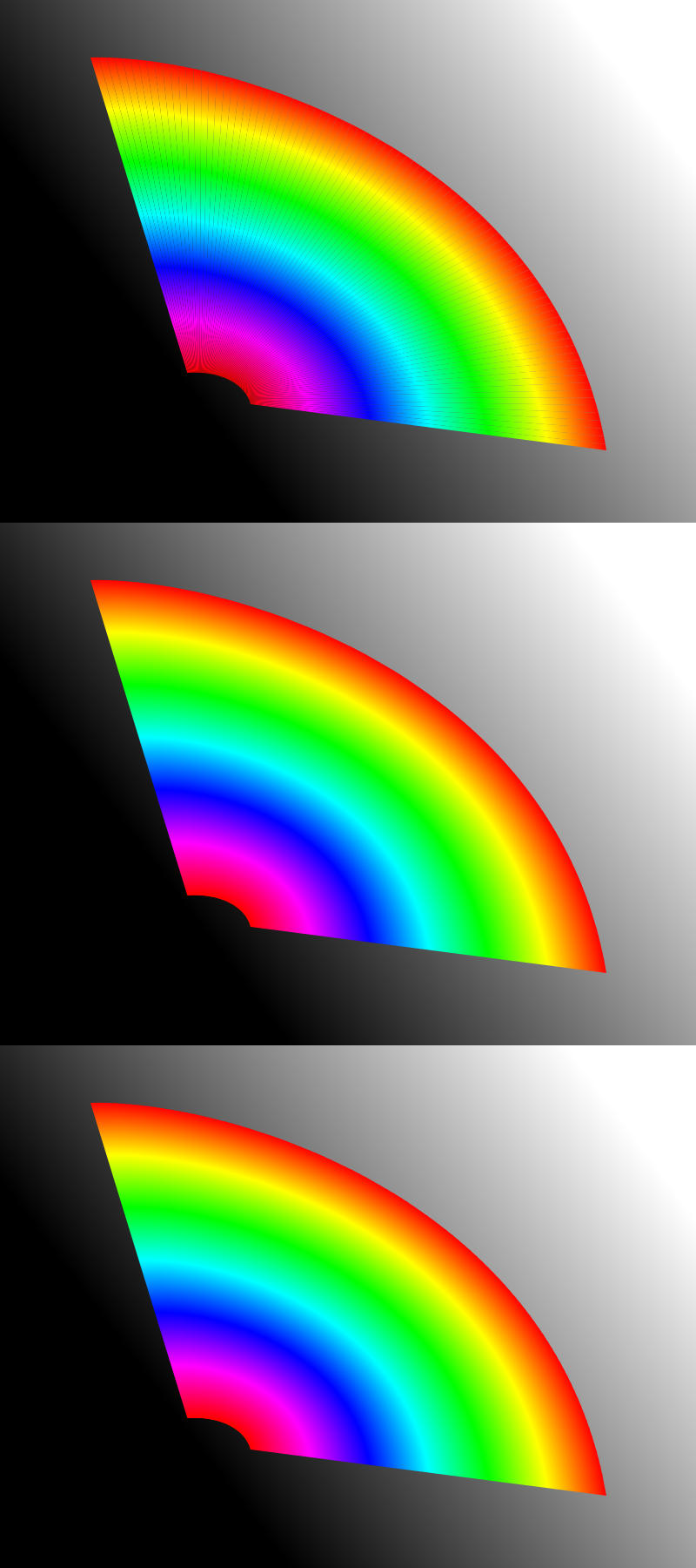

Pat625 wrote:
RobA, I have the problem of not knowing what the overlap function is, or how to use it. I played with the slider but did not notice any changes. What am I doing wrong?
It is really subtle. With an overlap of 0 you will usually end up with semi-transparent gaps between each stroke, or a moire pattern. Top is 0, middle is 1, bottom is 2
With the default (1) it is usually fin, but depending on the ratio of the paths or their orientation there may still be gaps, so you can dial it up to 2.
It is a question of speed versus quality, as it makes more strokes, closer together when it is at 1 or 2.

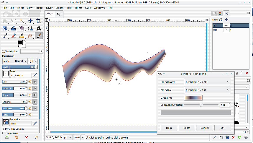

I came to this particular thread to review because of my heavy reliance on Path-Blend to generate smooth transitions in heightmaps, and I'm encountering an error (in GIMP 2.10) I have not seen before, or seen mentioned in the thread.
Following my workflow, I've created a simple path around an object, then duplicated that path, to ensure both paths have the same numbers of nodes. and then enlarged the second path by dragging nodes away from the first's. Finally, I ran PathBlend with a simple FG-to-BG gradient using the two paths.
I got an abort with this error:
Error: ( : 1) eval: unbound variable: CUSTOM-MODE
Reading back through the thread, it seems I was something of a cogniscento minore earlier on, but I can barely identify with that guy today.
I see lines like:
(gimp-edit-blend inLayer CUSTOM-MODE NORMAL-MODE GRADIENT-LINEAR 100 0 REPEAT-NONE FALSE TRUE 3 0.2 TRUE x3 y3 xQ yQ)
in the script, and do not see, for example, CUSTOM-MODE defined, so guess that it's something to be inherited from GIMP.
It is only a guess, but it seems possible that something has changed between v2.8 I used then and v2.10 now.
Anyone recognize the error, thanks?

Try this one, works here kubuntu 20.04 / Gimp 2.10.32 remember to unzip it It is script-fu put it in your scripts folder.

@rich2005, thanks.
That one gives the same result: "Error: ( : 1) eval: unbound variable: CUSTOM-MODE"
On further investigation:
Edit->Preferences: Folders: Scripts
lists two paths:
/usr/share/gimp/2.0/scripts/
~/.config/GIMP/2.10/scripts/
This may mean nothing, but I notice that variable, or parameter, CUSTOM-MODE appears--only--in scripts in the my GIMP profile directory, where scripts have been gathered over time (an copied into this directory most likely from earlier GIMP versions). CUSTOM-MODE does not appear in--any--scripts in the global share directory. To me it feels like older scripts written based on expectations that have been supplanted.

Strange how that one worked for me, however it was an old fix for a between Gimp 2.8 & Gimp 2.10
Only a couple of lines to update. Try this one.
ra-path_blend-210.zip [2.62 KiB]
Downloaded 73 times
I would check that you do not have an old version somewhere in your setup.
