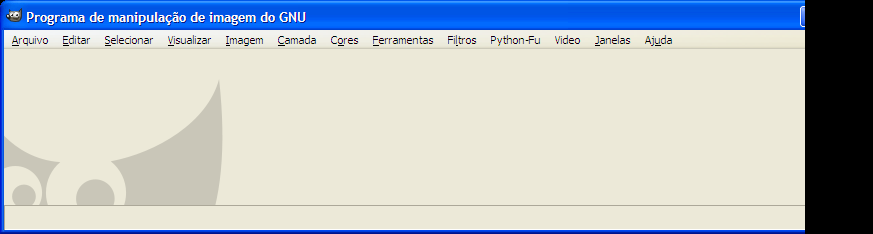

After installed script-fu.exe, the menu "Script-fu" and "FX-Foundry" disappeared.

I can't imagine the Script-Fu plug-in having any affect on menu options. I have a "Script-Fu" menu that's unaffected by adding the new Script-Fu plug-in. I guess you could remove it and see of those menus come back, but my guess is something else changed.

I removed the script-fu.exe. I openned GIMP and the menus came back again.
I watched my folder plug-ins. There's no other script-fu plug-in there.

Carlos, try rich2005's suggestion. There would be no other script-fu.exe in your user plug-ins folder, but there would be one in your system plug-ins folder.
As rich2005 suggests, back up the old script-fu.exe first in your system plug-ins folder and then copy in the new one. That way, if you have problems, you can restore the original.

I removed the old plugin "script-fu.exe from "C:\Arquivos de programas\GIMP 2\lib\gimp\2.0\plug-ins". I put the new plugin there. I openned theGimp. The menus FX-Foundry and Script-fu disappeared again.
I'm not sure what might be happening, Carlos.
What version of Windows are you using?
What version of GIMP are you using?
Are you using the 32bit plug-in or the 64bit plug-in?

I'm using the 32bit plugin.
My OS: Windows XP.
Gimp versiom: 2.8.10

Carlos, MareroQ said there might be some problems with the 32 bit version but most users aren't having any problems.
Can you run gimp from a command prompt to see of there are any messages that might give us a clue as to what is happening?
Perhaps the fact that I've applied the updated code to the latest version of script-fu-interface.c is causing problems with GIMP 2.8.10 on some machines. You are the first who has reported problems with the latest script-fu-interface code , but I can take a look into that possibility.
