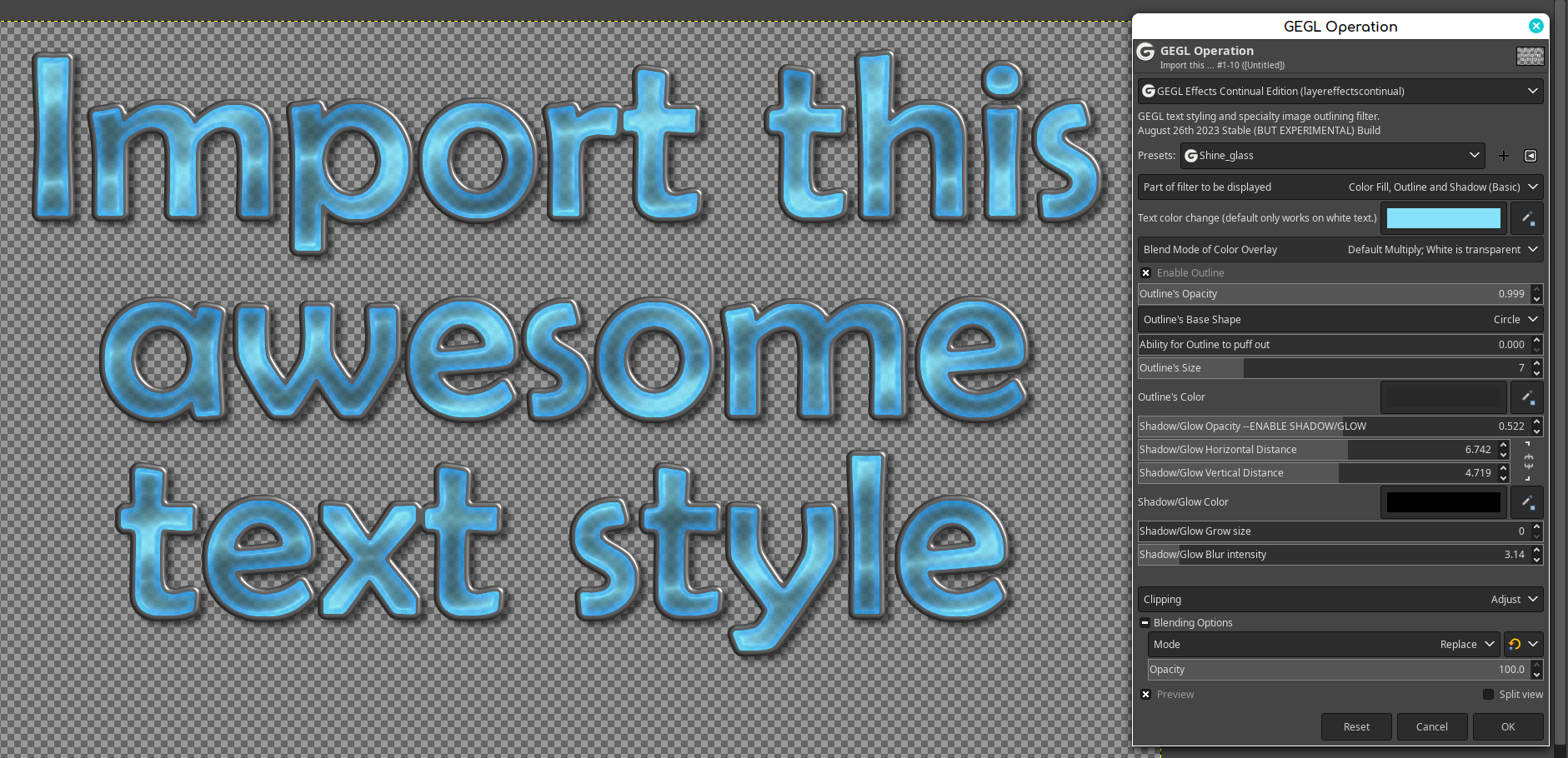

Try these text files as imports. They make these text styles
https://cdn.discordapp.com/attachments/ ... /indi_text
https://cdn.discordapp.com/attachments/ ... 4/gel_text
https://cdn.discordapp.com/attachments/ ... lass_metal

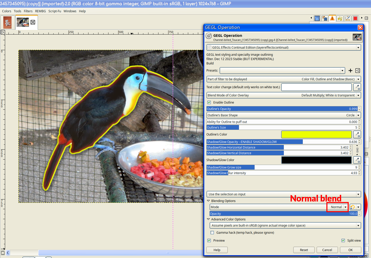

I could put my bash plugin that calls AI in a special build of GEGL Effects layer effects engine. It will be located in a 9th tab with a checkbox to run the bash string.
If done users will be able do anything and everything in one plugin.

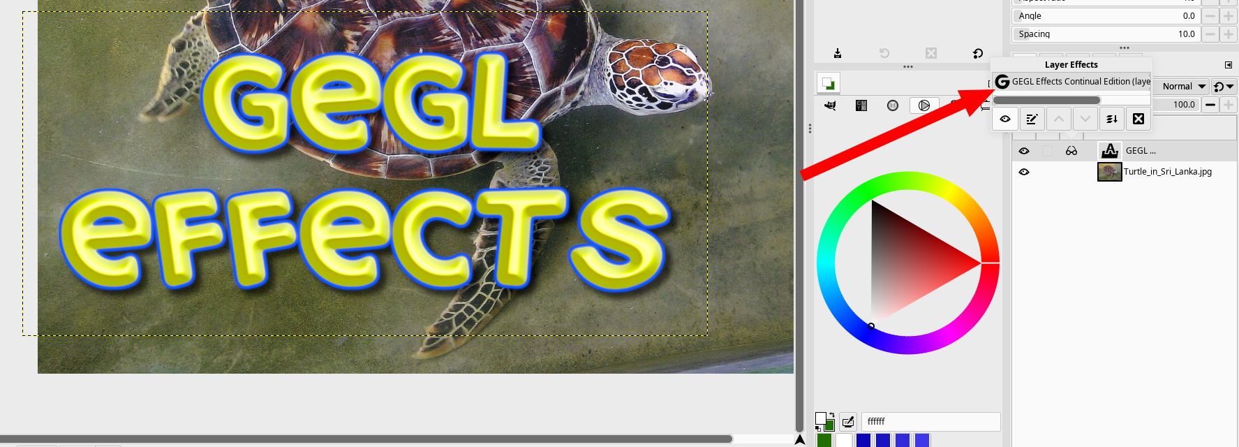

Thread hit a new page so now comes the usual.
GEGL Effects the text styling plugin in Gimp that also outlines images.
