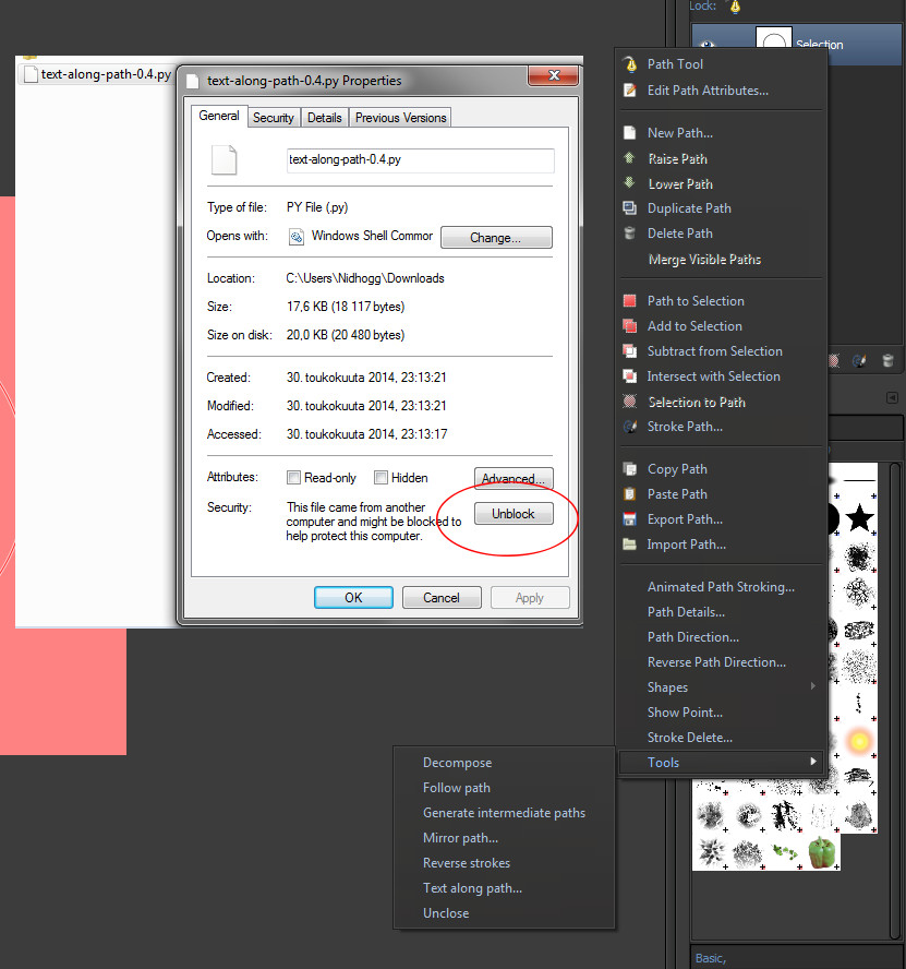

Ella Louise wrote:
I downloaded the plug-in but in the path window I don’t see ‘Tools’.
I must have done something wrong :(
So, I did it my way ;) :)
Step 1, always after downloading a script or plugin. Make sure it is not blocked. It will not load otherwise.
Then put it in your user/.gimp-2.8/plugins folder
After You have created a path, right-click the path in paths docker and there it is, under Tools.

Esper, I placed it in the plug in folder.
Nidhogg, after a look at your printscreen, I noticed I downloaded a wrong one :oops:
Removed it, downloaded the right plug in and now it’s OK :)

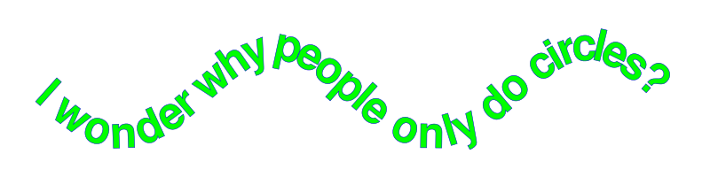

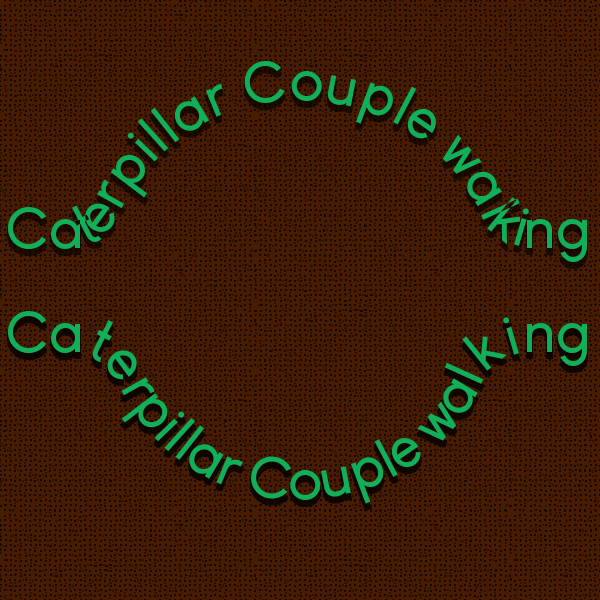

i was about to write part two for the ofnuts 'Text-Along-Path Plug-in' tutorial, featuring his proposed technique of deleting a segment to get a perfectly aligned text, but it seems there are problems
ofnuts wrote:
Ideally you want a circle path with the starting point on the vertical diameter so that centering the text in it puts it directly at the right place. With my shape tool the first point of the circle is on the segment you use so it is very easy to obtain. But with a path from a circle selection you can cheat:
  • Create a vertical guide on the diameter (and disable "Snap to guide")
  • Start the path tool
  • Zoom to max on the bottom of the circle
  • Add two points to the circle, on each side and very close to the guide (ctrl-click)
  • Delete the sub-pixel segment between the two points (Ctrl-shift-click it)
Now you have a path is circular, but slightly open with a first point which is very close to the diameter (as close as 0.1 pixel if needed). Therefore the plugin wil really center the text as you want it. For the bottom text, just flip the path vertically, the opening will be at the top and you'll have also reversed the stroke to get upright letters.

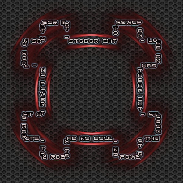

apparently, depending on the font (and in this case it didnt matter if i used upper or lower case letters), the two sets of text dont align, no matter what 'Height Reference' i use
that means the solution to make this work is by using two seperate paths (or using the 'Vertical Adjust', but i think its almost easier, creating a second path)

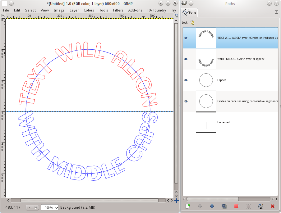

1) The only case where you can expect the top and bottom text to align exactly on the same path is when you use a "height reference" that is perfectly centered on all characters. In the current version this means using all-caps for text and the "Middle of caps" reference:
(it would be easy to add a "middle of lowercase", though...).
The "Vertical alignment" parameter is also meant to deal with these issues.

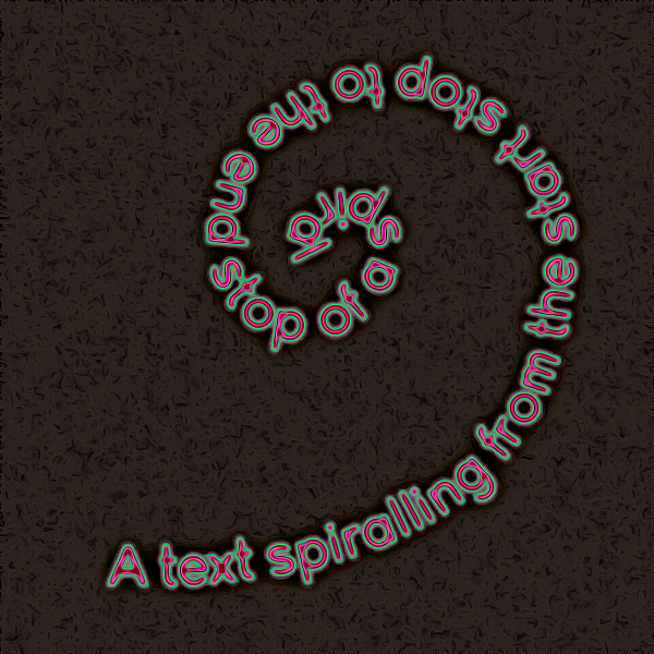

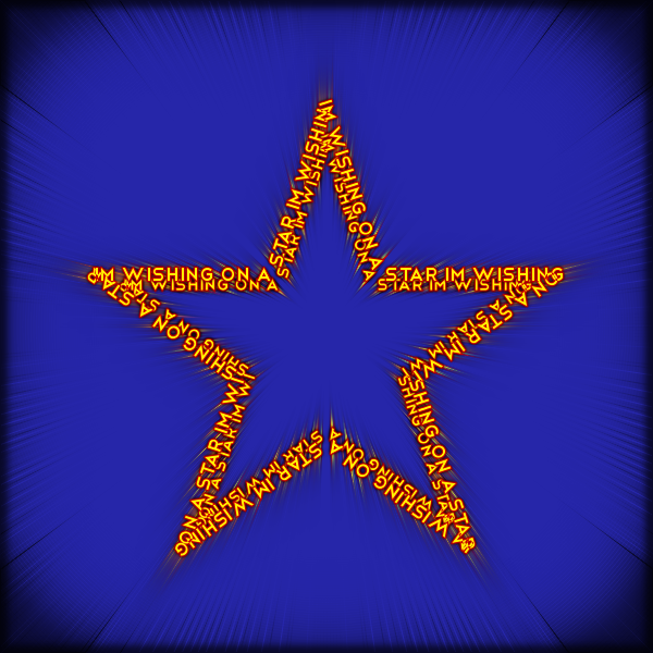

and i found another minor bug:
when paths overlap, they dont merge, they form an exclusion
playing around with a spiral path
and a star
