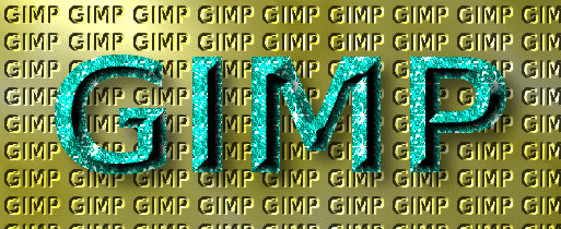

This one using Sinus

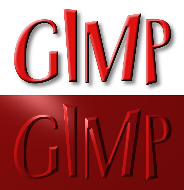

Beveled red text. Then made a layer the color of the red text over the bump map, put it through the bump map in lighting effects.
