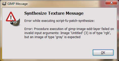

I'm getting to believe it's pretty much needs a complete revamp Saul. Anyway, now this is what I get. When I first run the Script-fu, I get this error:
Not doing anything else, when I re-run the Script-fu, I get this:

After putting in saulgoode's changes, these are the error messages I got. After the top message, I changed the image to grayscale, then got the second message after running the script again. Using in Fedora Linux

That is bad,it seems a nonsense for a similar script require images be in Grayscale .

No additional libraries were needed for Ubuntu (that I am aware of).
The script is posted on the very first post. You can follow Saulgoode's comments to make the necessary changes. Or if you want, I can email you a copy of the updated script.
I downloaded the script from here:
http://www.logarithmic.net/pfh/textureops (textureops-0.3.tar.gz)
I compiled texturetiler.c and sharpfeather.c using gimptool (both worked after compiling)
patchsymth.scm fix suggestions by Saulgoode:
Try changing the following line:
(while (not (= old '()))
to:
(while (pair? old)
And:
Substitute
(while (pair? point-list)
for
(while (not (= point-list nil))
