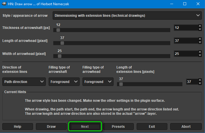

All new features and new arrow type is very useful for me.
Thank You for the quick implementation.
Last request:
Is it possible to add the "Next arrow" function (without restarting the plugin, i.e. describing the entire drawing in one session)?

Using this start file, the user can make important settings such as whether the journal recording for UNDO by GIMP is active/inactive and a lot more!
Please continue to enjoy using my plugin.
