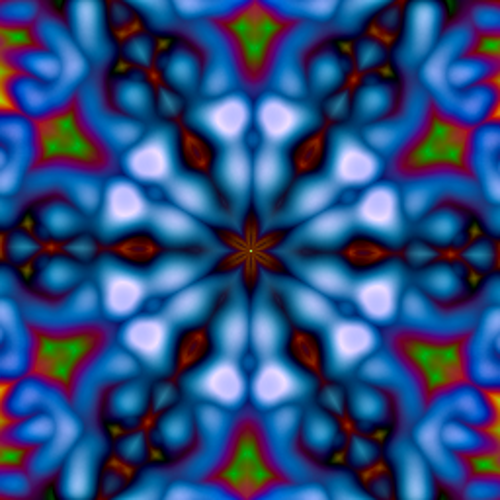

Yes Liana all the images were done using Volute Abstraite from the Luminescence script. Just like these ones
AND HOPEFULLY THIS ONE
I hope you like them
