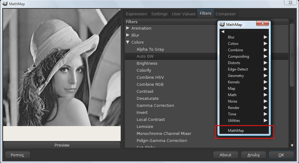

Rellik419
Just a suggestion - no file intl.dll.
Is your system does not show the details of the error?
Mackenzieh
There are two types of files:
1 *. mm
2 *. mmc (math map composer) - as for me - I can open these files only if you start Mathmap (not the menu Gimp)

Why is it that the mathmap filters work through the gimp menu and the math map composer filters don't? Shouldn't they all be able to work through the gimp menu?
I always avoid that menu because open only a limited version of MM interface
You may check from yourself, if you go to Filters> Generic>MathMap> Mathmap you may access to all MM filters, try several different filters , even edit filters on the fly
But all the other item in MM menu to me are only a disturbance , often somebody report some bug regarding this missing menu , i would like have a similar bug because i found that menu misleading and superfluous.
So honestly i don't know what suggest to add filters in that menu, because from that menu instead i would like remove EVERYTHING except Mathmap>Mathmap.

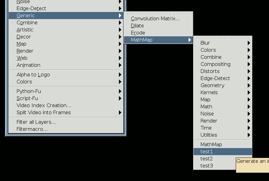

You can install your composer filters to the menu but it takes a little bit of finagling.
  1. Create your filter in the Composer tab. If you want to edit it later, then save it in the Composer tab (this saves the Composer source code of your filter with a .mmc extension).
  2. Switch to the Expression tab.
  3. Scroll down to the bottom and find a line that starts with "filter __composer_filter__".
  4. Modify the "__composer_filter__" to be a unique name. This name will appear as the title of the filter's box in the Composer builder (should you later decide to combine this filter with other filters). It does not matter what the name is, but no two filters can share the same name.
  5. Save the file using the buttons at the bottom of the Expression tab (this saves the C source code of your filter). The name of your file (without the .mm extension) will be the name of the menu command.
  6. Exit GIMP. (GIMP does not provide a way to refresh plug-ins.)
  7. Delete your ~/.gimp-2.8/pluginrc file. GIMP uses this file to avoid having to load plug-ins at startup, however, this file doesn't get updated by Mathmap so by deleting the file, we force GIMP to load the changes you've made.
You can now open GIMP and your filter should appear at the bottom of the MathMap menu.
