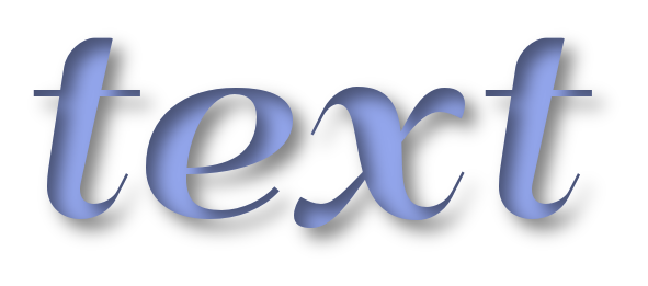

swathi wrote:
Hai
Can we do shadow like shown in the below image
thank you
That looks like an extruded shadow. I'll put that one the list for consideration, swathi. I might need to do a stand alone script for that. Maybe, I'll create two versions of this script, one like it stands now and another with gradient & extruded shadows.

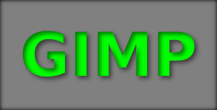

Here I've done Inner shadow to text(with merge down), then drop shadow to text(with merge down),
then on on the background I've used inner-shadow and glow (with merge down), on all the shadows settings default
the Image was done with a couple of minor tweaks to the script
 Post subject: Re: GC Shadow V0.4
PostPosted: Wed May 29, 2013 7:25 pm  (#31)
I like your results, Graechan. Adding merge (for the selected and new layer only) sounds like a useful option and will save you a couple of clicks.
I was getting ready to post the new version with the corrected layer positioning (issue O had pointed out) but I think I'll go ahead and add that merge option (for selected and new layers) before I release version V0.05.
Thanks!
