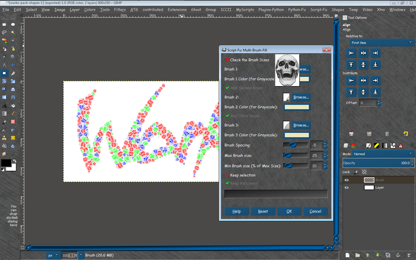

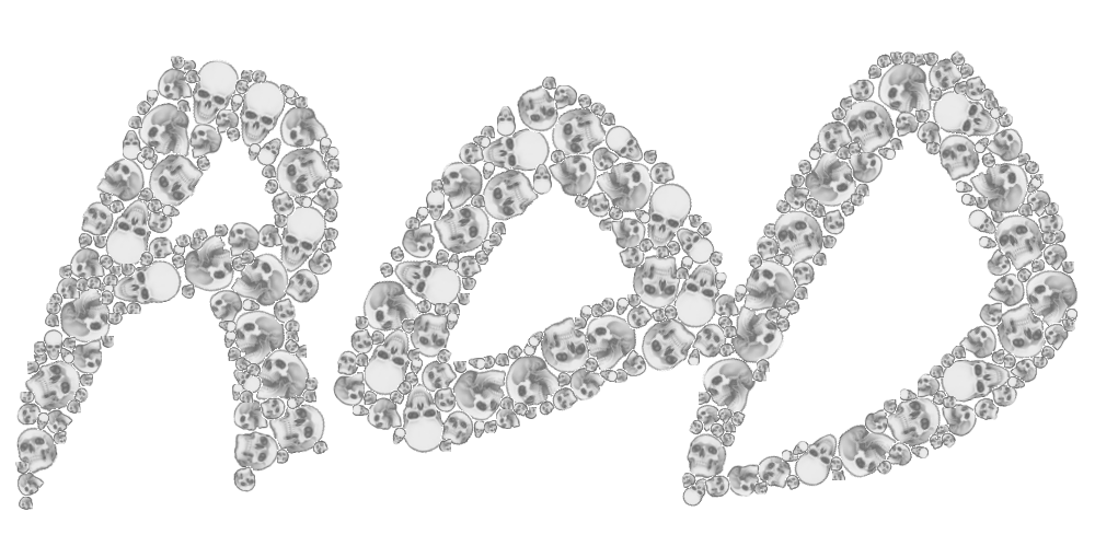

Graechan using just one layer with text and alpha channel worked but my color selection was ignored.
My settings
I think i know what happened. These brushes are not grayscale.
Is there a way to make the script ignore default colors or turn them off for NON grayscale brushes?

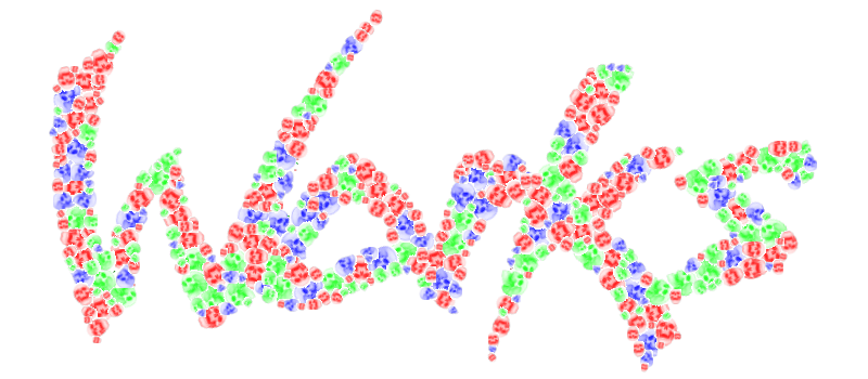

Graechan wrote:
Thanks Warrior, did you have any problem with the instructions,
Not really. I made a mask. I thought it would fill the transparent portion, but it filled the background. I just reversed it, and ran it again.

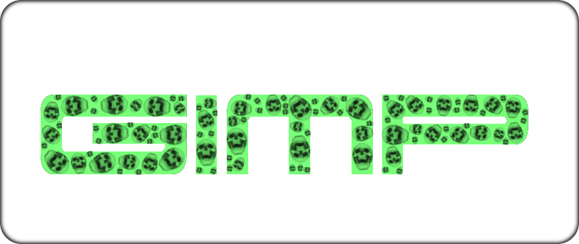

Script has been updated to Rel2 (Bugfix for running on multiple layers)
an image well known by my friend Graechan...
nice, isn't it?
Yes I know angel well and she looks great in this excellent Image
Thanks to Dinasset and all those who posted Images
The script only sets the f/g color before applying the brush this should only affect grayscale brushes, so to apply greyscale brush without color,
set color for that brush to black, non greyscale brushes should retain there native color

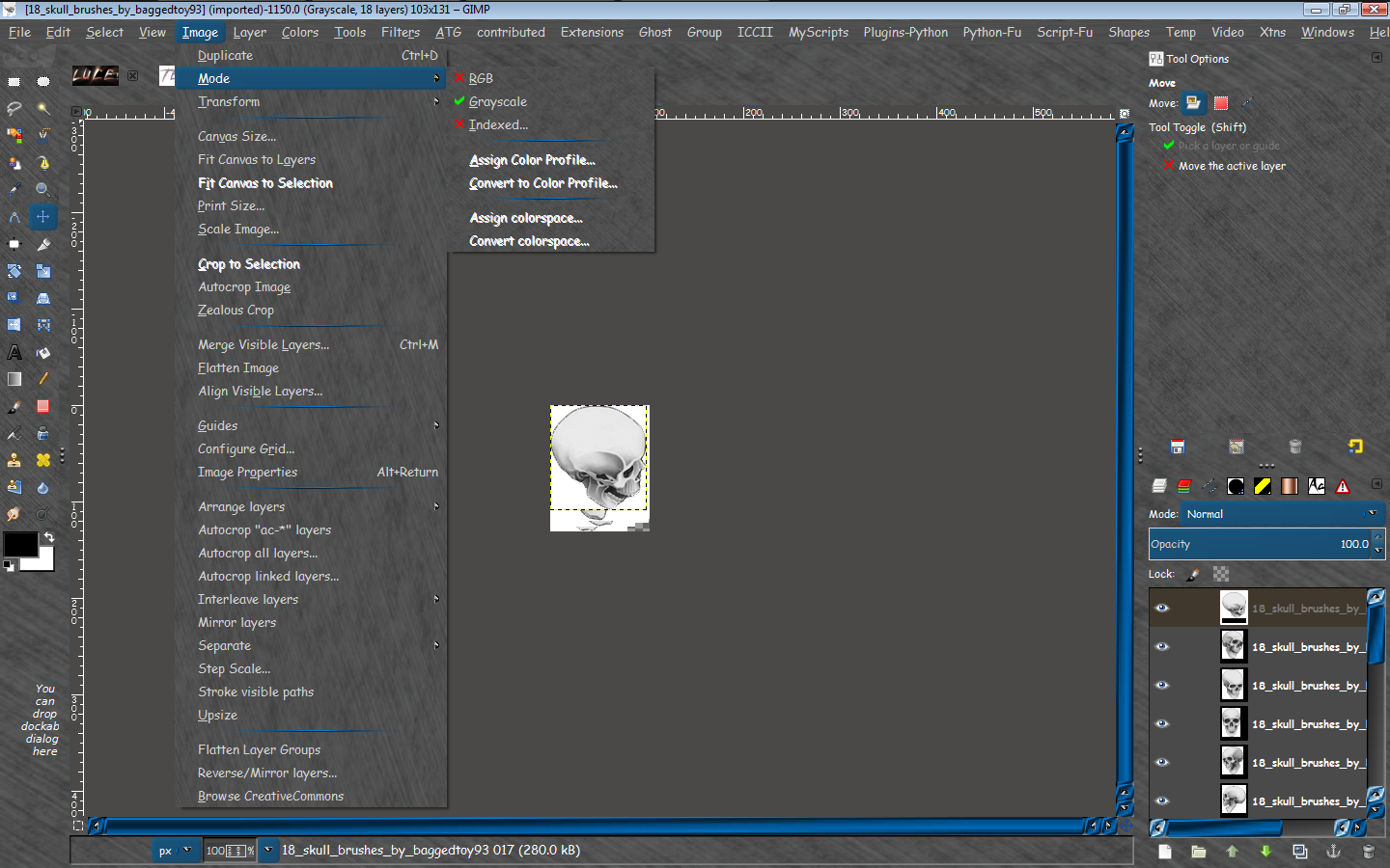

I opened the ABR as images and they are grayscale.
Could you add the option for ABR format?

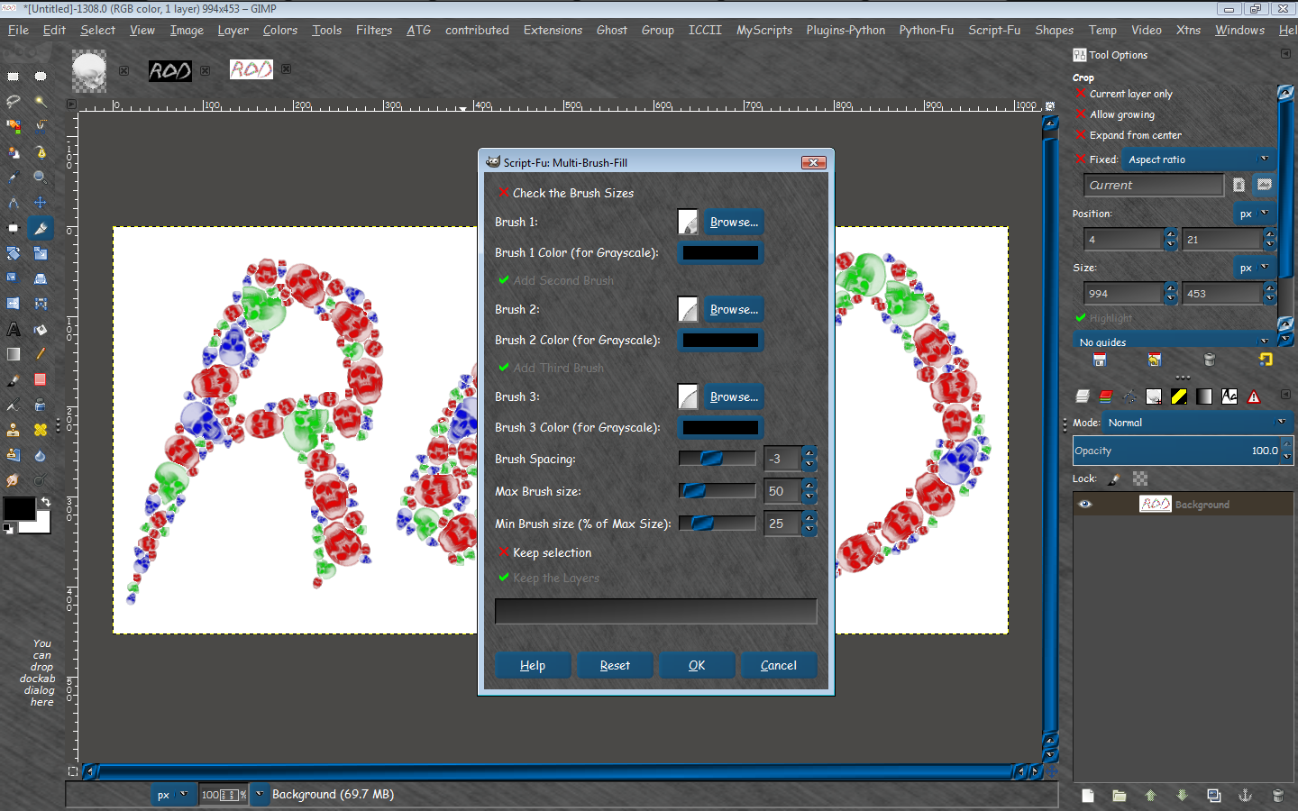

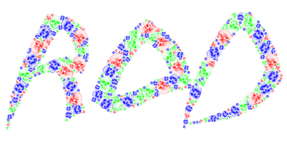

I think i figured out the problem. These are partially transparent brushes and color isn't working with them.
I had to open each one as a image, alpha to select it and add a white bg and flatten.Then save as grayscale.
Then paste as brush. :lol Still didn't work as alpha to select selected partial areas of the brush.No way to fix i guess.
I don't understand why the color isn't getting picked up other than that. ABR brushes work fine in pack sprites with GMIC though. :)
Graechan maybe a addition to the script to use current brush at 3 sizes? You could only use one brush but that may work.

Rod it was partially my fault, I have updated script please download again and set your brush1 color to blacK

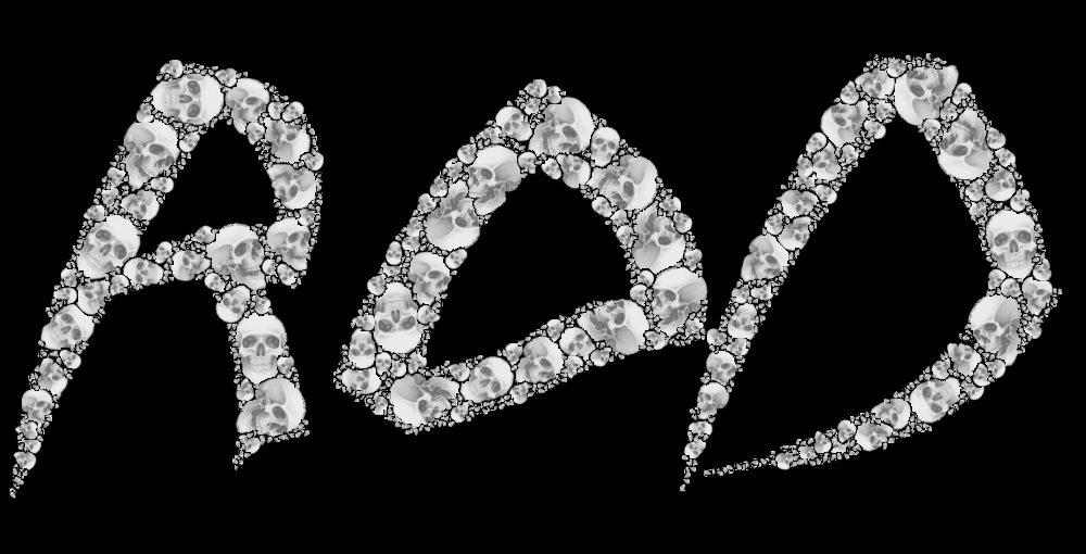

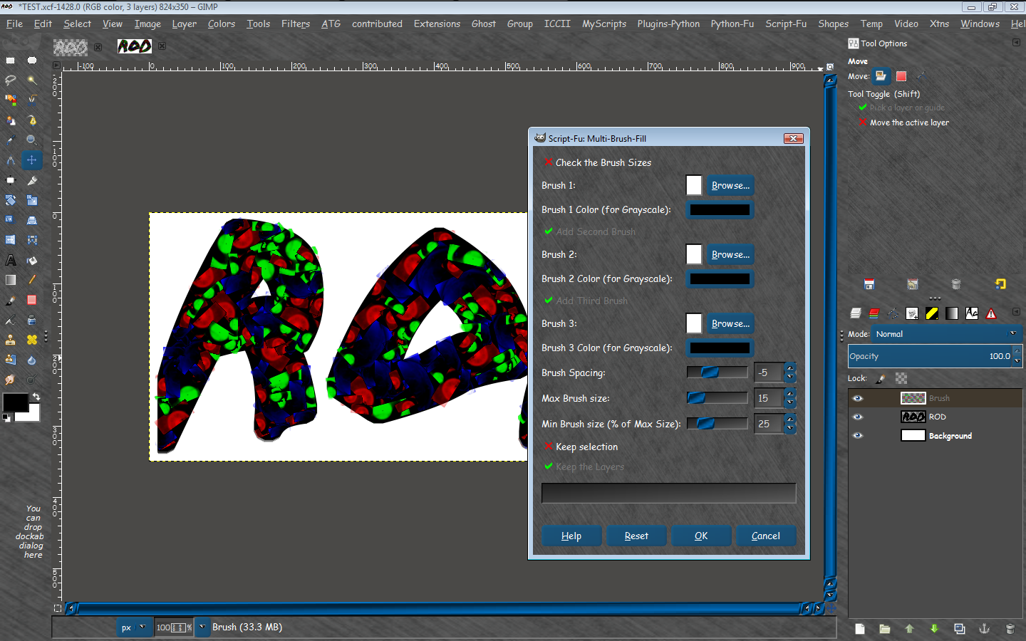

Woops re read your instructions and changed JUST the brush #1 to black. :)
Still isn't working.

Rod did you download Rel2 again as the original Rel2 had a typo that prevented the f/g selector from working, and if your using brush2 or 3 you will have to set their colors as well

Rod I somehow uploaded the same old file should be fixed now Sorry about that :oops:
