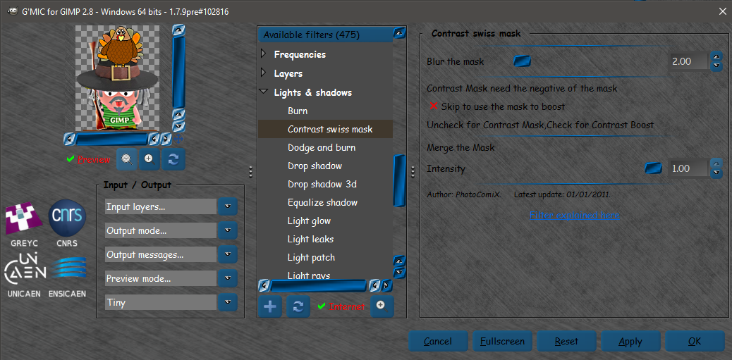

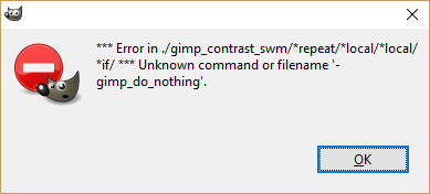

This nice filter doesn't work correct (for me, it never did, but it didn't bother me, until now.)
When I check the SKIP button ...then the effect will be the opposite of a traditional Contrast Mask, I get the following error:
-if {$2==0} -negative[1] -elif {$2==1} -gimp_do_nothing -endif
G'MIC doesn't know: -gimp_do_nothing
when I remove this "-gimp_do_nothing" from the code, the filter seems to work correct, but I'm not sure it works as intended? ;)
Does everyone else has this error, when checking the SKIP button?

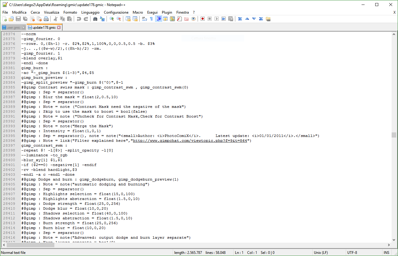

PostPosted: Mon Oct 31, 2016 2:20 pm  (#25)
correct, it happens also to myself
I guess you may remove also the elif and leave only
-if {$2==0} -negative[1] -endif
anyhow this is a matter od David (Ronounours)

PostPosted: Mon Oct 31, 2016 3:15 pm  (#26)
Joined: Jan 03, 2011
Posts: 1656
Should be fixed now.
Thanks for reporting !

Is the .gmic file needing to be in a different location for Windows 10. It's not working in Application Data.
 Post subject: Re: updated- Costrast Swiss Mask
PostPosted: Tue Nov 01, 2016 12:46 am  (#29)
For me it's there and working
PostPosted: Tue Nov 01, 2016 8:40 am  (#30)
I was looking in the wrong place in GMIC filters. Thanks!
