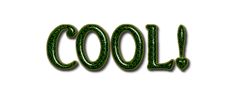

PhotoComix wrote:
COOL! :) No pun intended.
Font is called "Christmas"
I used your script to create a default snow covered text. Then i selected only the text layer and ran my "Lizard Breath" script with hex and squares size 5. Then i selected just the colored text layer (Original-image-layer) , and ran color balance on JUST shadows (99 on Cyan).
Results looked like Christmas candy to me. :jumpclap
Cool..but what does yours Lizard Breath Script ? i am really curious to see what effect may be remind a lizard breath
Download "Lizard Breath" script here.
Download "Original Lizard Breath" and "Reptile" here
Thanks again to Graechan for adding "Shine" to the filter for me. :hi5
NOTE: You cannot use both "Lizard Breath" scripts installed together. One will not work. The "Lizard Breath" i posted in the first download or top download link is with "Shine added" and is the same effect but glossier. :bigthup
