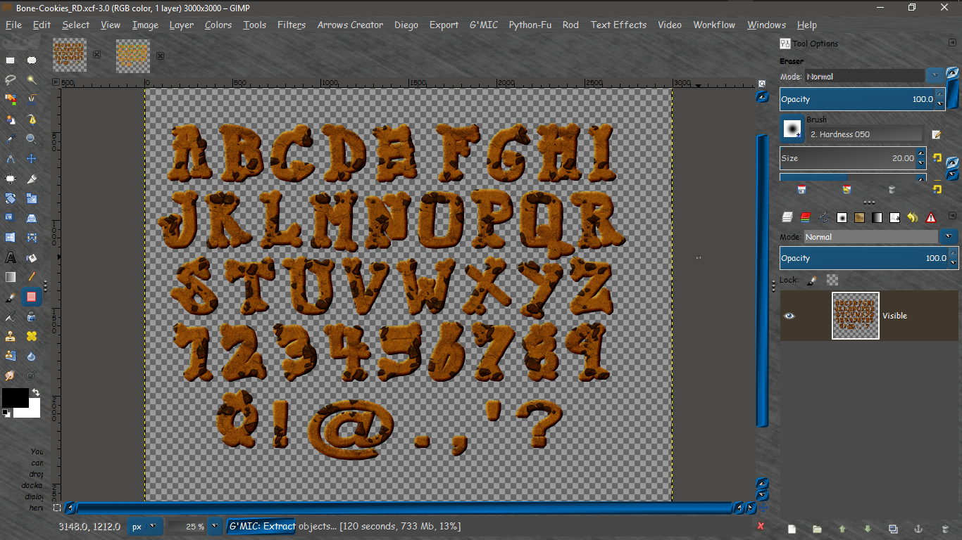

LOL! I figured out the error Tran!
I wasn't adding the "space.png" layer. Works excellent now. :) Also creators of these XCF files should be sure the space.png is a smaller layer so each word is spaced correctly. I ended up dividing (re scaling) the "space.png" layer by 2 TWICE. This correctly spaced the words.
 Post subject: Re: Custom Font script (spawned from Wallace's PhotoFont topic).
PostPosted: Tue Oct 04, 2016 1:19 pm  (#240)
Posts: 4469
Oh yeah "space.png" or " .png" works.
I usually just copy the "A.png" then rename it to " .png" and then delete the content so that it's blank and it's all good.
