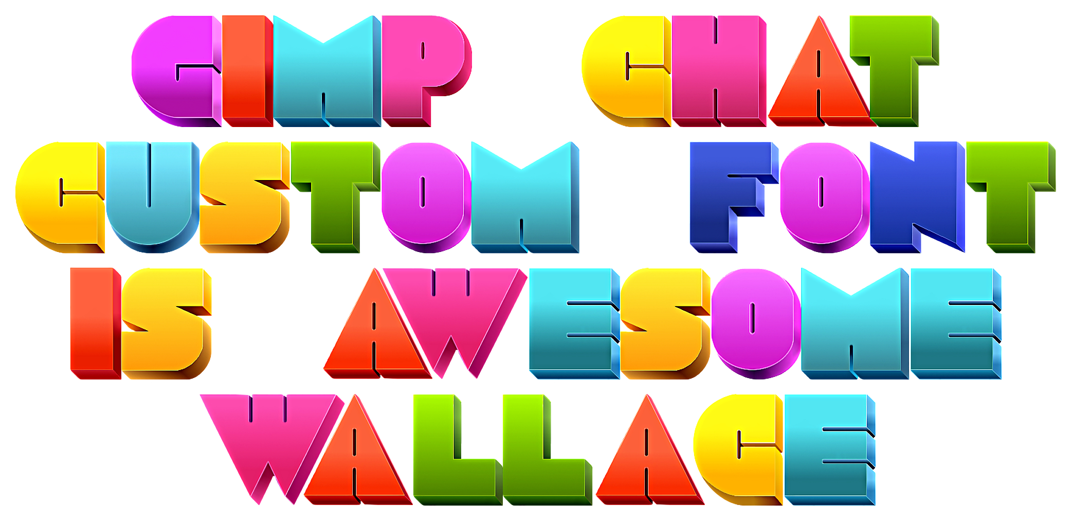

Okay, here's test version of script with kerning (version 15).
custom_font.scm [14.64 KiB]
Downloaded 134 times
make sure you all caps for text like "GIMP CHAT CUSTOM FONT IS AWESOME"... so that it's explicit and the script doesn't have to try to look for caps if it isn't there. Then this kerning works.
define a vector named for example "AT.png" and define a path start from left of A and ends at about 3/4 of the width A where the T should start.
define a vector named for example "AW.png" and define a path start from left of A and ends about 1/2 the width of A where he W should start...
and now we have kerning.
sample

trandoductin wrote:
Okay, here's test version of script with kerning.
custom_font.scm
define a vector named for example "AT.png" and define a path start from left of A and ends at about 3/4 of the width A where the T should star.
sample
That looks great!
:jumpclap
But there's still some rounding off of the font edges?

Posts: 4561
that's because i still used the old .xcf that i am testing with fuzziness of 100. heheh :hehe
here's a better .xcf with vectors AT.png, AW.png, WA.png, AC.png defined
Wallace_3D_colorful_font.xcf [947.12 KiB]
Downloaded 200 times
EDIT: AT could be a little wider, but you get the idea.
and AWESOME which needs definition of AW.png to get A and Ws closer together.
Great work on the font Wallace! :jumpclap
Rod and Wallace..good catch on the spacing, now we have optional kerning definition.

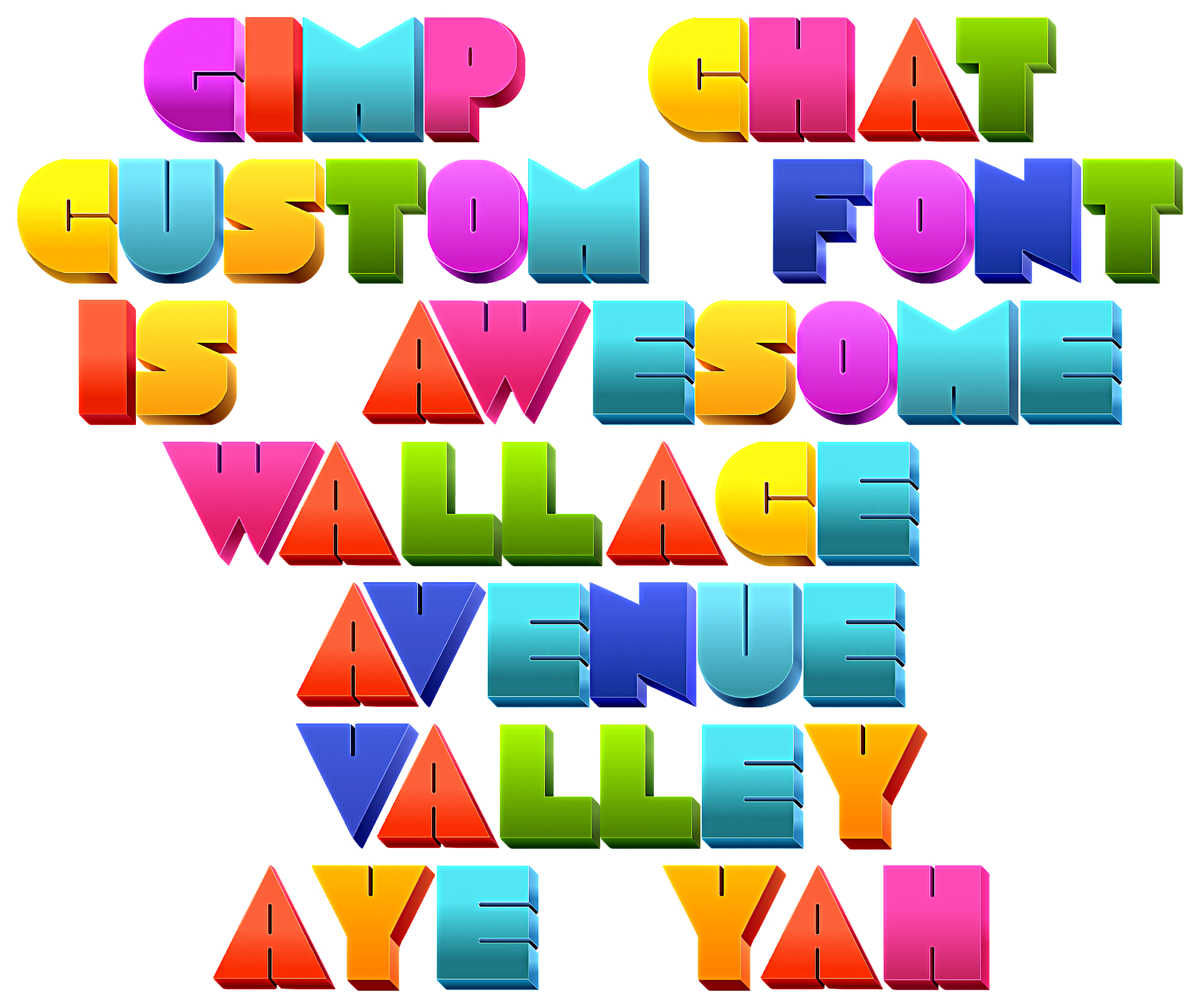

forgot to define vectors other cases like AV,VA, TA, AY, YE so this font has those
Wallace_3D_colorful_font.xcf [947.59 KiB]
Downloaded 209 times
