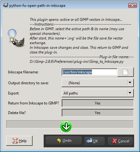

Your new gimpfu.py is sensational in the idea :tyspin - very useful for recurring activities (but with modified parameters) - preview the effect in the window! :coolthup (Dream: a would add another option "undo" would not need to use the Ctrl + Z).
A small suggestion: if you add even a scroll bar (because now the dilemma - which gimpfu use)?

MareroQ: Thanks for trying this 'gimpfu.py'. Your idea of an 'undo' button (for the last cycle) seems a necessity for the preview aspect :cool .

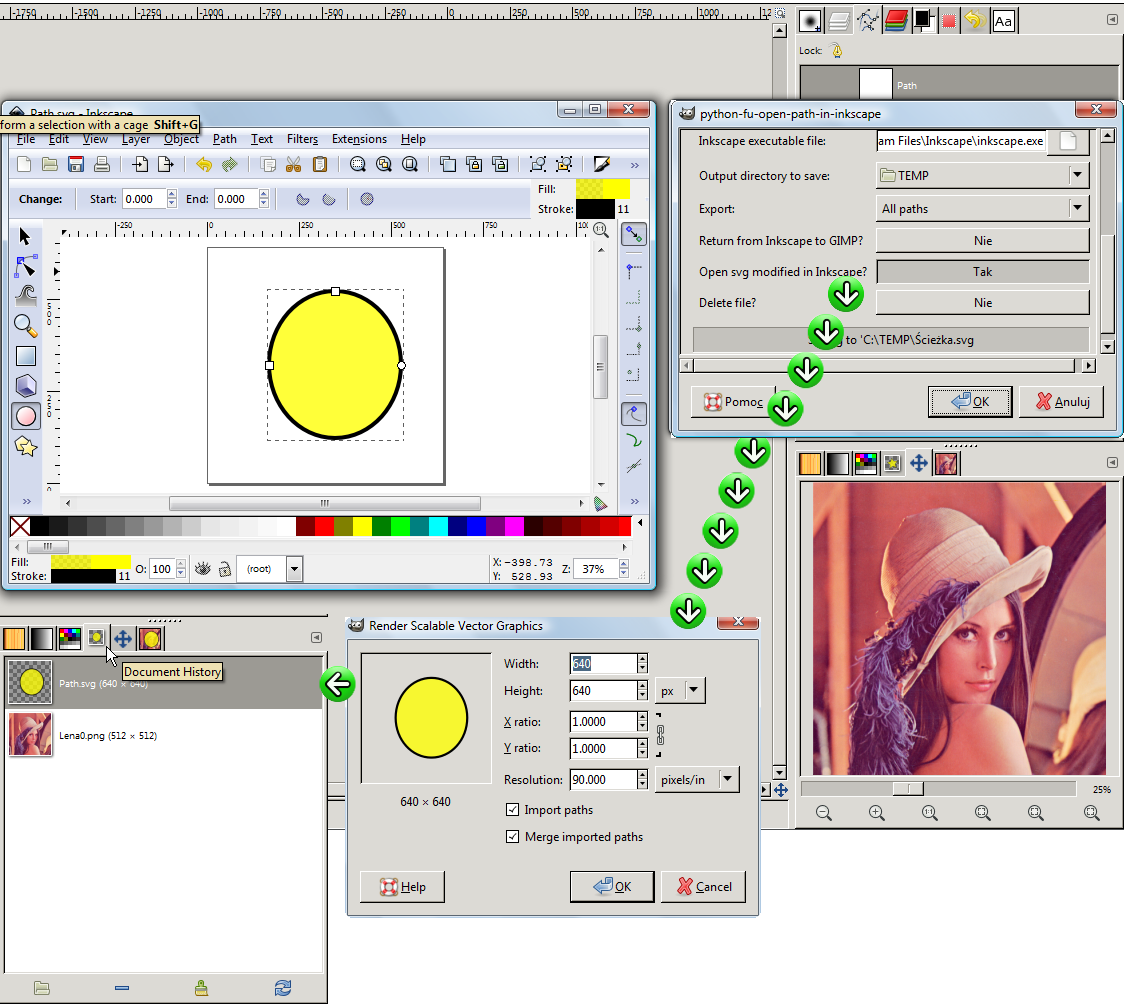

- I added a new option: Open svg modified in Inkscape? (although it is possible that a better option would be to open svg as layer or as a choice open as a new image - but I tried again, unsuccessfully);

This is what I wanted to (unsuccessfully) to achieve.
Now, as I look at Your code it seems simple and obvious - but I have not found a solution for many hours.
Thank You for Your help and code - again something I learned from You.
Now it is more than vectors - so I suggest you change the name in the menu:
of "Vectors to Inkscape & ..." on "Connection to Inkscape & ...
Robert - if You agree to such a change?
As for me, this is the final version.
