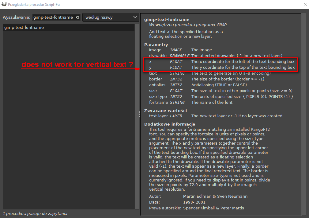

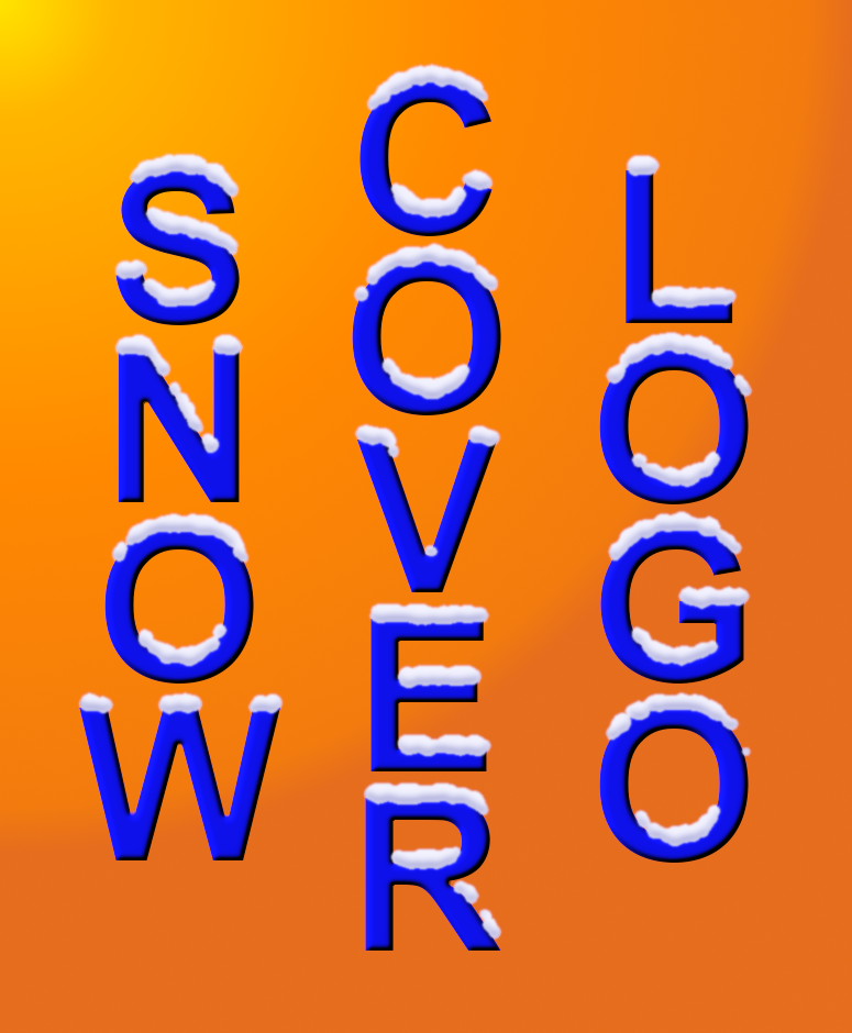

Hi Graechan.
Have you coded anything with vertical text lately?
In my attempts, the x or y coordinate for the top of the text bounding box does not work for vertical text.
If I'm wrong, maybe you have an example when it works?
Now I have to add some extra code for the border.
Additional request - if you will update, can you include changes in naming such as:
NORMAL-MODE -> LAYER-MODE-NORMAL
ADD-SELECTION-MASK -> ADD-MASK-SELECTION
BACKGROUND-FILL -> FILL-BACKGROUND
(because I am afraid that soon Gimp will only work without compatibility mode with older versions).

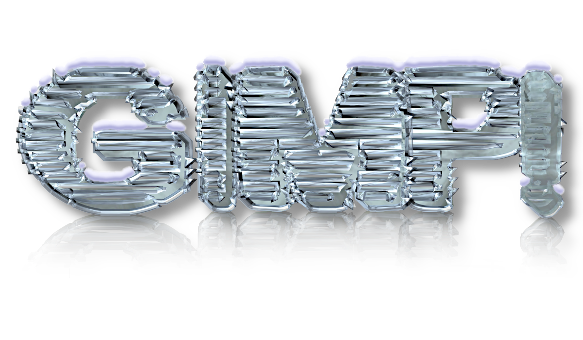

Getting ready to release ICE Custom Font! :bigthup
I thought this would be a good place to pile some snow on it. :tyspin Graechan wherever you are! :bigthup
Many Gimp Chat folks are truly missed. :(
One for you Graechan. :) :tyspin

That is an awesome font, Rod thank you for shared! Do you have a script or plugin of it? Do you have a tutorial on how to create it?
Thank you Pocholo! :tyspin
The font name is - A Cut Above The Rest - FREE for personal use
https://www.1001freefonts.com/search.ph ... search.y=3
I created the effect in a 3D program Aurora 3D Maker (for text or logos). Cost is about $50.00 USD.
https://www.presentation-3d.com/products/maker-3d.html
I created each png layer as a separate image (why so big), and then edited as layers in Gimp to create the Custom Font ICE_RD. I actually cut each image down to half its size and still ended up with a huge Custom Font file. (171 MB)
https://sourceforge.net/projects/rods-c ... f/download
Although writing a script for it could be fun. :gimp
