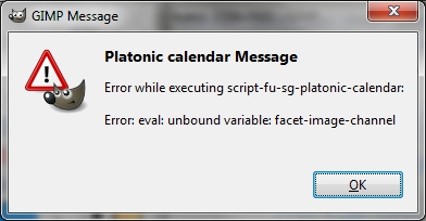

I downloaded the latest script and when I run it, with facets enabled, I get the following error. Then if I click on any layer, after clicking ok in the error box, the image comes up beautifully. Very odd indeed.

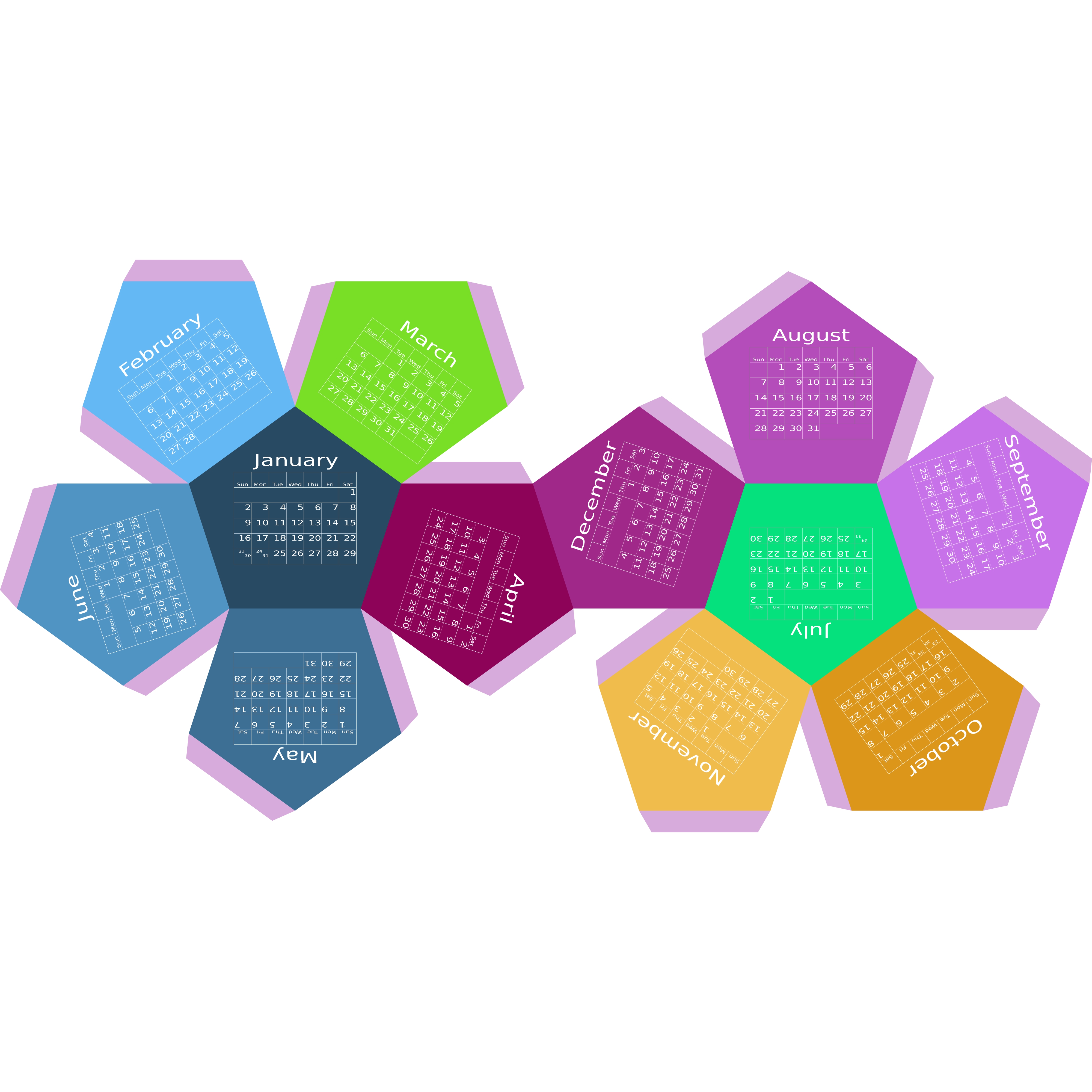

I ran the script once and got the image, then again without the facets, to get the fold lines and filled in the tabs. This is my result, after lowering the fold layer.
My Sigs = My Photos
 Post subject: Re: Platonic Calendar Script-fu (beta)
PostPosted: Sat Jan 15, 2011 8:24 pm  (#47)

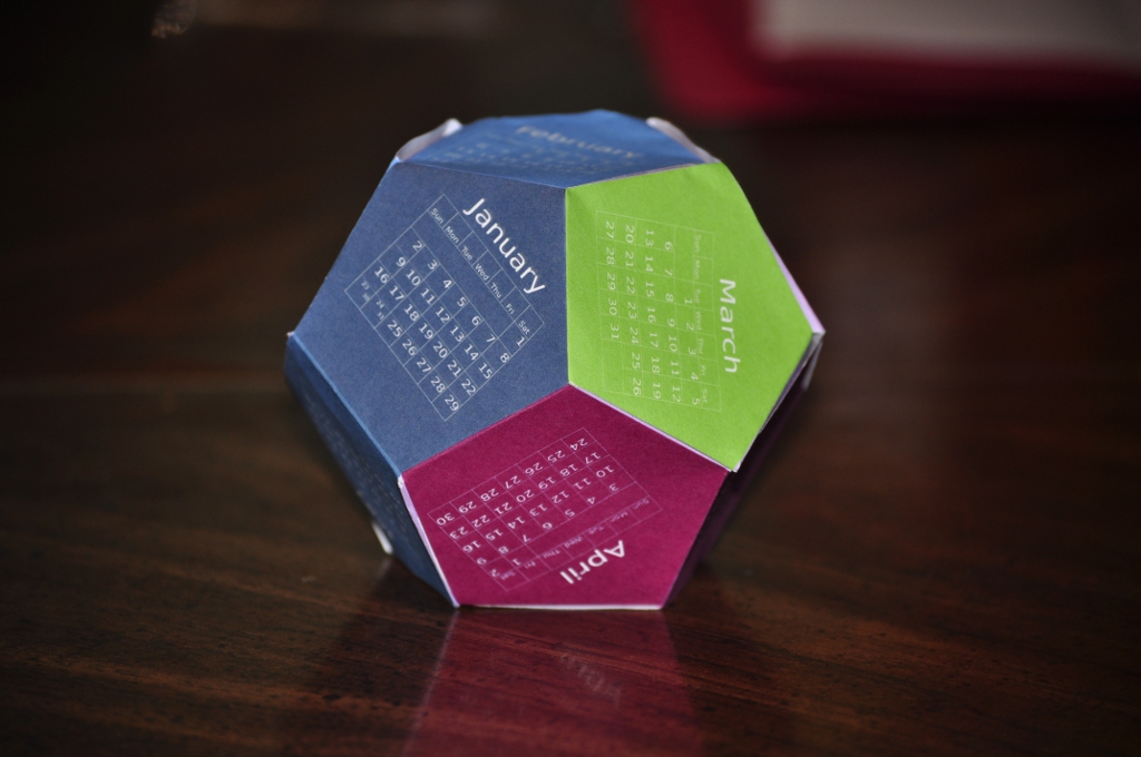

That is way beyond cool Greg. I will be interested to see it all folded up. Hope you don't get tied in knots with the scotch tape the way I did. lol. very pretty.....

My original image put together. I wasn't going to show how horribly I put it together, but this is it. And I did get my fingers taped together. I have to go through my art case for double stick mounting tape for the next one!
Oops. There should be a space between "facet-image" and "channel" (not a hyphen). I will provide an updated version tomorrow. I just upgraded my system this morning haven't yet set up the synchronicity with my Chiselapp repository.

Hey Saul, You rock! I made the change in the script and it's problem solved!! The script is running perfectly!!

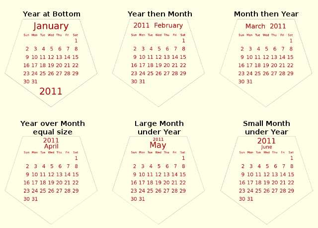

A new version of the script has been released and is ready for testing. Improvements are for the most part merely aesthetic but it required a significant amount of recoding (so there may be errors).
List of changes:
  • Month names are now normalized to all be the same size (previously months with short names such as "May" would be much larger than longer-named months such as "November").
  • A channel is created which permits easy selection of all of the facets.
  • A channel is created which permits easy selection of all of the text.
  • The default for the "Edge length" option is now "400" which should work for printing out on either normal letter size (8.5"x11") or DIN A4 sheets at a resolution of 300 DPI.
  • A new option for placing the year underneath the calendar on a facet has been added.
Here is a sampling which shows the result of the various banner layout choices:
