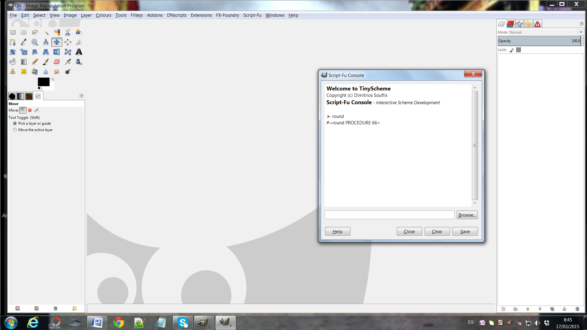

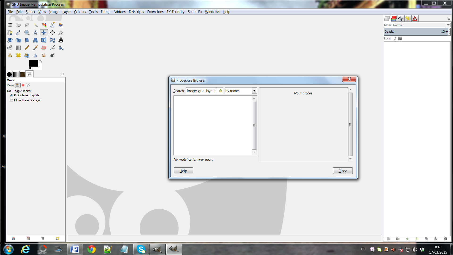

Hello everybody. At the end I think I've found my naughty hidden grid-layout and of course I have enjoyed removing it. :hehe
I found it when I opened program files until I opened scripts fold, and there it was. Before I opened by via user etc...
So please, could you confirm me if it is all right now?
Here my last test:
 Post subject: Re: Need Help Testing A Simple Script
PostPosted: Tue Mar 17, 2015 8:25 am  (#53)
Issabella, it look like your good to go. :bigthup

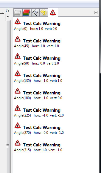

I did my Test Calc. I hope everything is all right now. ;)
PostPosted: Tue Mar 17, 2015 12:09 pm  (#56)
Looks good, Issabella. You're getting the correct results. :bigthup
