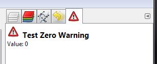

GnuTux, here my two results. First I put the slider to 0; Then reset and set the slider to 0.
