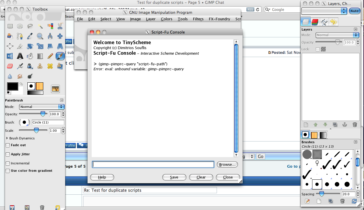

OK, I typed the line into the proper place in the script-fu console, but nothing happened. Do I need to click something?Image

PostPosted: Sat Nov 26, 2011 10:16 pm  (#45)
Ok, here ya' go....finally.

It looks like you've maybe typed in 'gimp-pimprc-query' -- can you perhaps provide a more zoomed-in screenshot?

This time I copied and pasted so I wouldn't make an error!

Thanks for that. You've successfully shown that MACs are doing things the same way as Linux, at least as far as path separators are concerned.
