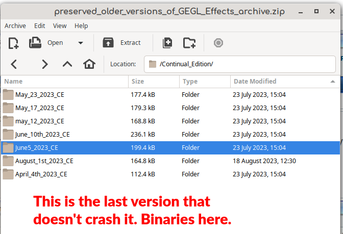

I just confirmed that GEGL Effects June 10th and up has the problem. Before June tenth it was fine. Downgrade is here.
YOU CAN ONLY HAVE ONE VERSION OF GEGL EFFECTS AND YOU HAVE TO OVERWRITE ALL OF ITS BINARIES NOT JUST ONE VERSION.
https://github.com/LinuxBeaver/GEGL-Eff ... _final.zip
I am looking for a fix actively. The biggest change to GEGL Effects in June 10th was the addition of "Glass on Text" as part of it.

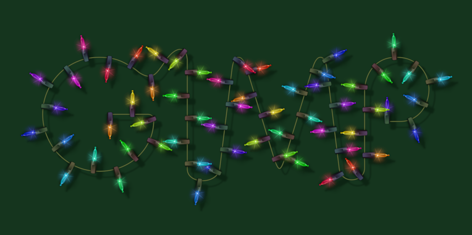

PostPosted: Sat Dec 09, 2023 2:03 pm  (#63)
Joined: Dec 09, 2018
Posts: 745
Merry Christmas :hehe
Using a layer from the brush LittleLights.gih posted by mahvin.
Made with plugins ofn-brush-strokes-on-path.py, rotate-hue.py, ofn-interleave-layers.py.
