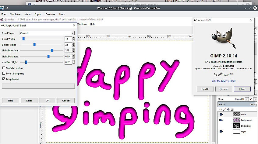

A quick look and the procedure gimp-edit-bucket-fill is no longer in Gimp 2.10 The script will work ok since Gimp 2.10 has compatibility mode enabled by default. It would be nice to get it 100% gimp 2.10 though.
 Post subject: Re: GT Bevel V1.0
PostPosted: Sat Nov 16, 2019 7:50 am  (#68)
Posts: 2630
GT-Bevel was updated for Gimp 2.10 The updated script is attached or look at previous posts
For Windows put gt-bevel-updt.scm in C:\Users\"yourname"\AppData\Roaming\GIMP\2.10\scripts
That is ok up-to-and-including Gimp 2.10.12. There has been much updating 'old code' to GEGL for Gimp 2.10.14 and the script now only partially works. Makes a bump-map layer but does not complete. Might be a bug in the update or might not.
The fix (if you can call it a fix) is use the old bump map plugin, bumpmap64.exe also in the zip.
Put that in C:\Users\"yourname"\AppData\Roaming\GIMP\2.10\plug-ins
looks like this
gt-bevel-210.zip [31.35 KiB]
Downloaded 573 times
