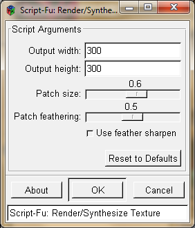

Homogenize and Multitile are GIMP 1.x plugins PC (not scripts). The Synthsize Texture Script-fu has an option for Feather Sharpen and that doesn't work. When I uncheck that option, it was still buggy (the version that supposedly works for GIMP 2.x that is). I pretty much hosed everything but Make Seamless Texture (that one works in GIMP 2.x). I'll check your link to Multitile but I believe it is still only for GIMP 1.x. :)
Feather sharpen is now compiled (as everything in textureops) but NOT for 2.6 ONLY for 2.7.2 and ONLY for 64 bit download/file.php?id=1861
well a 32 bit version should follow soon anyway that is what ready now
...and sure without that the script will give errors at least if that option is checked
