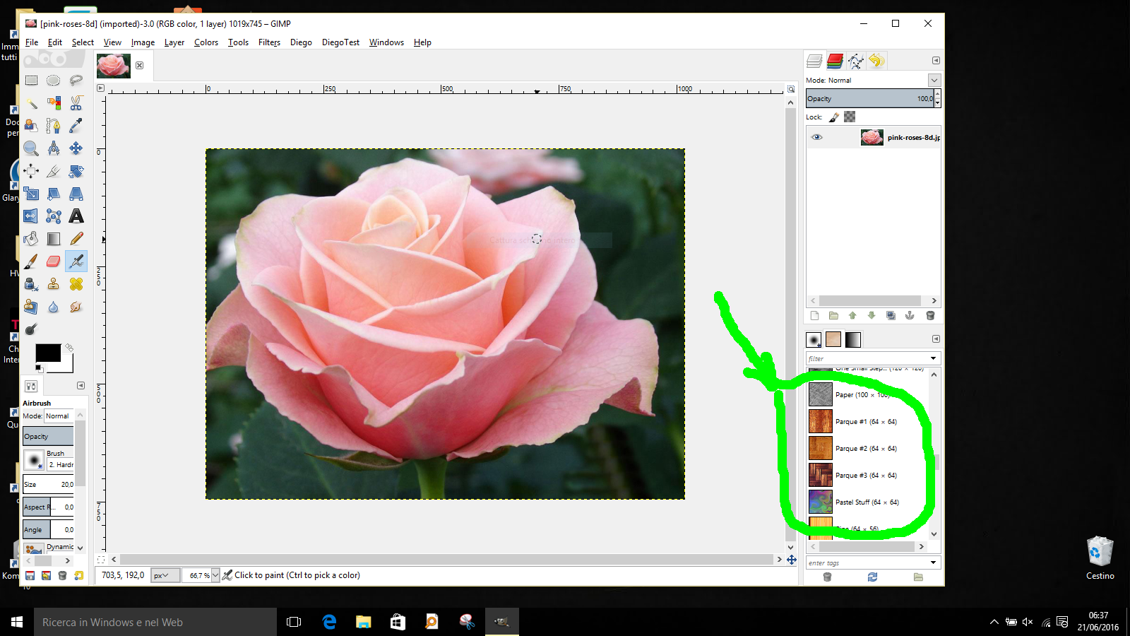

2-look at (browse) the patterns you have available to find a common substring, I found to have some which have the substring "pa"

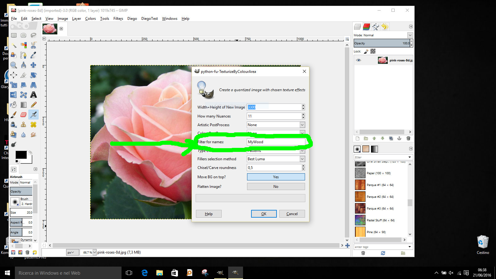

3-open the filter, defaults (the Filter for names says: MyWood)
