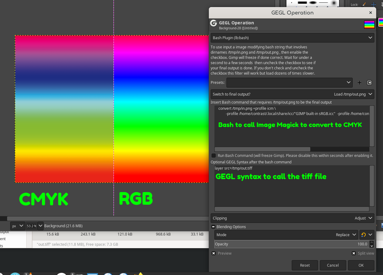

CmykStudent wrote:
contrast_: Cool! As a heads-up, PNG doesn't support CMYK (the CMYK colors would be treated as RGB on export). You would need to export as a TIFF or JPEG if you want the exported file to be treated as CMYK by other programs.
ok I'll use tiff

ok, it worked for real. I need to retract the other two post.

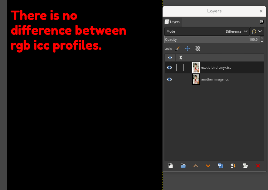

Step two might only have to be done once as I see no difference in rgb icc profiles. This makes automation easier.

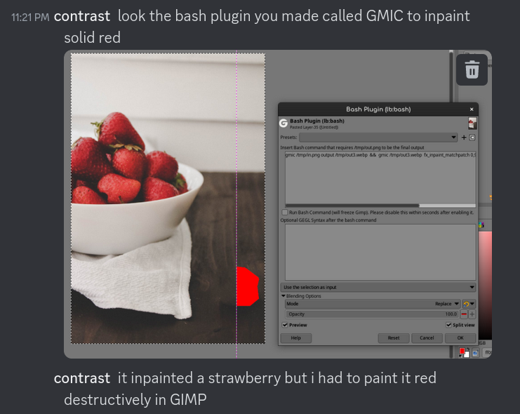

Inpainting (removing) a strawberry by calling GMIC from bash in GIMP 2.99.19
https://github.com/LinuxBeaver/AI_in_Gi ... h/releases
This plugin was used to call GMIC's inpainting tool with GEGL at a set preset by running one of these commands in GEGL bash plugin
gmic /tmp/in.png output /tmp/out3.webp  &&  gmic /tmp/out3.webp fx_inpaint_patch 7,16,0.1,1.2,0,0.05,10,1,255,0,0,255,0,0 -o /tmp/out.png
gmic /tmp/in.png output /tmp/out3.webp  &&  gmic /tmp/out3.webp  fx_inpaint_matchpatch 0,9,10,5,1,255,0,0,255,0,0 -o /tmp/out.png
Remember it doesn't work proper non-destructively so the layer effect has to be merged (made destructive) in 2.99.19 after applying.

I paint the strawberry red destructively on a GIMP layer then I run the bash command to call GMIC
