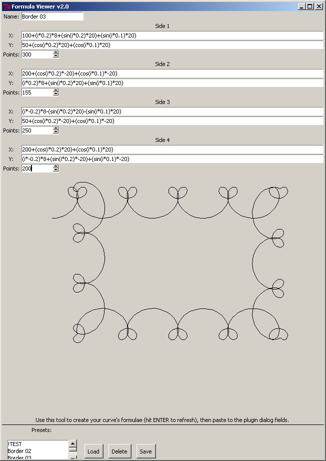

Hi guys,
thanks for all your feedback. I will clean up some code and post updates the soonest.
I am also working out yet one more feature - I'd like user to be able to generate a rectangular path/border.
Also, there will be a Formula Viewer update.
BTW, there is a bug in Formula Viewer code:
            except:
                msg.showwarning("Error","Your formula has an error")
                break
            self.plotOne (canvas,Width,Height)
move last line one TAB to left (out of the loop),
to read
            except:
                break
The App will update MUCH faster.
Sorry for that mistake on my part. Of course it will be addressed in the next update.
